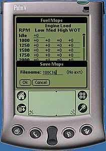

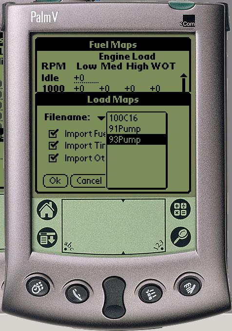

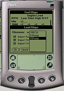

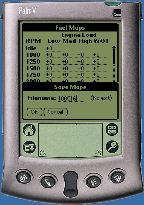

In response to several requests, I used today to implement saving and loading maps in the Palm software. See screenshots. Works just like the Windows software - you can load just the fuel maps, just the timing maps, just the other things, or any combination.
This is pretty handy in that now you don't have to drag around a laptop to switch maps.
This feature will be in the next software release for the silver box units, which'll be out as soon as I get some more stuff implemented.
And happy holidays to all!
Tom
