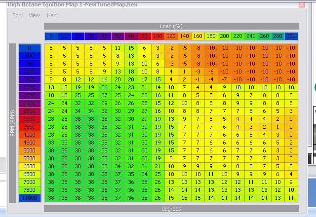

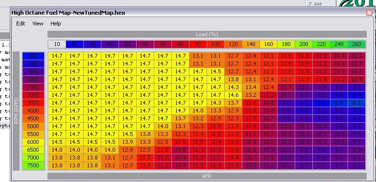

I recently put in a new fuel and timing table into the ecu, it works great on 3rd gear pulls... but in 4th around 3500-4000 it knocks... usually around 6s and 7 counts then fads off to 4,3,1 and 0 again. I attached the
here is the log. Any idea as to why?
And the maps are here also.
Any help would be great Thanks!
Attached Thumbnails Need some help, Map knocks in 4th.?-fuelmap.jpg   Need some help, Map knocks in 4th.?-timingmap.jpg

The engine simply works harder in higher gears and is more prone to knock under the same circumstances. If the knock is consistent, you'll have to drop the timing advance.

hm i have notice that i spiked once in4th to 23 instead of the tuned 22. So that would make sense. The only thing consistant i've noticed is that when i get 6, 7 counts of knock, the ecu registers a lower ocatne level... even though its all on the same tank of gas. The knock seems to be consistant, so i may retard the timing a bit. hopefully htat helps

the first thing I would look at is the fuel and determine whether or not it's right, if it's right and the boost is in check, then look at the timing and pull it back a bit in the are a where knock begins.

Agreed if the knock is consistant take a degree out right before the knock starts and you should eliminate it.
Taking a degree out before the knock starts, not where the knock is can make all the difference.
Now looking at your logs you run very low timing in that area.....i run 6-7 degrees at peak load and my afr is 12.0 and i have no knocking issues. I would say do more logs and see if its repetative before making changes.
