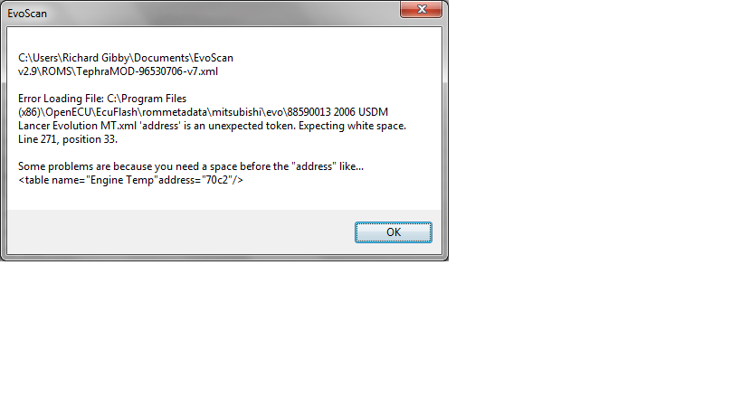

Am using the latestest tephra v7 maps and xmls. am using latest evoscan. I keep getting an error while using 94170715 and other roms as well stating that line 271 row 33 needs to be blank. it is trying to load an 06 xml.
I have copied the rom and xml to the evoscan rom directory with same error. I have reformated the computer and started with all new downloaded programs and files.
Im new to the latest tephra and evoscan versions so not sure what i am missing. I have gone through merlins guide as well as the maptrace guide from evoscan.

Attached screen capture

Post up your xml file so we can take a look.
