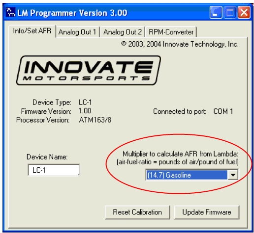

So I can't get my innovate xd-16 to work properly.
I did the free air calibrate several times, no errors in the process.
The numbers I'm getting when the car is running are about 4.6 avg and drop to 3's with the blip of the throttle.
Almost seems like it's displaying voltage ?
Anyone have any input ? My next plan is to try to connect it to a computer but haven't had a chance yet.

AFR calculation is set for Ethanol. Connect to your LC-1 using original cable and LMProgrammer software and change afr multiplier for gasoline.

Got it guys, took me wayyyy longer then I want to admit to get the serial adaptor driver to work with my computer..
The afr calculation was set to a custom setting, I couldn't make sence of the voltage offset and why it was set that way. I forgot to screen shot it. Not sure if it could of happened from just the battery dying.
But it's set back to gasoline, and working great !
Next I need to get ecu flash to work, time to read through 100 threads of possibilities. But I think it's time for a new laptop after 8 years.

This setting may jump back to "custom" if you plug\unplug the serial cable with power on. This can also happen when battery is dying or any other kind of abrupt power loss happen during connection etc...
