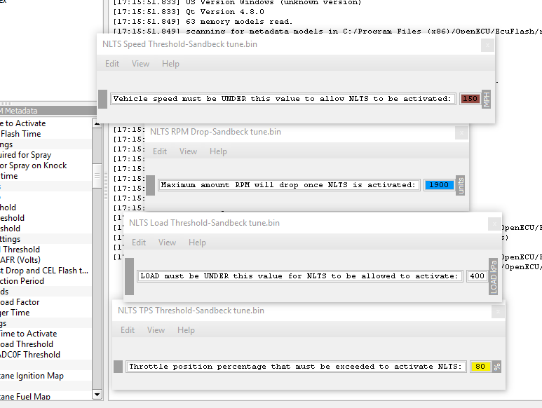

No lift shift has not been working on my 03 evo since i have owned it. My car is fully built with a sheptrans and a fp red around 550/450 wheel.
My buddy's evo 9 se with a fp green around 400/350 works no lift shift no problem
Any ideas why mine is unable too?
Here is a pic of my settings

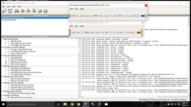

Try changing your load and speed threshold to these. I just double checked mine and it works. RPM drop is 800 and TPS is at 85%. Let me know if this works.
