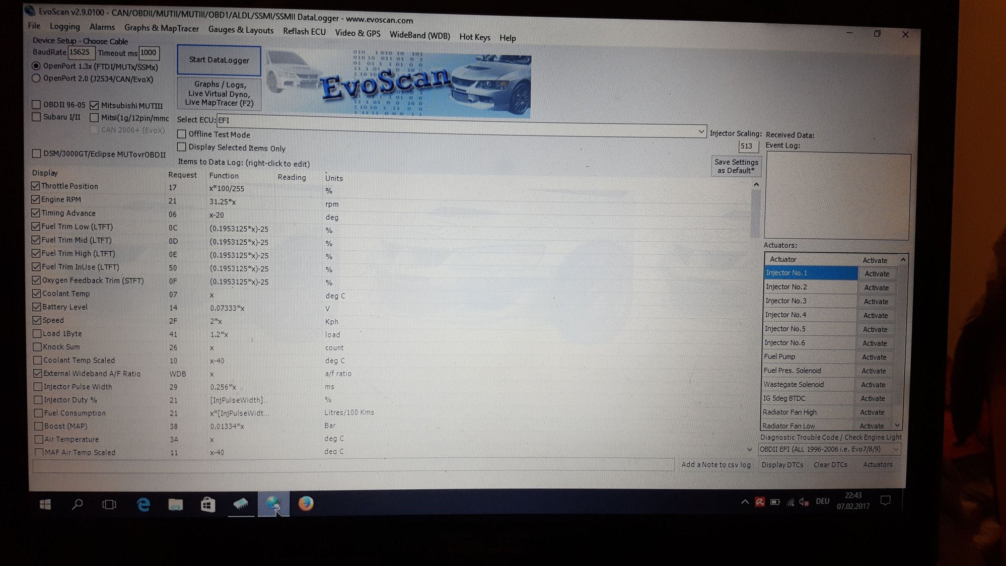

hi Guys I have a problem with EvoScan2.9. With the search function I found unfortunately not suitable. The problem: I have a 2005 evo8 edm. With ecuflash I can read my ecu. But if I want to log with evoscan, then I have no data, no rpm, no battery level no trotthle poition ... simply nothing. I use win10 and 1.3u openport cable. Evoscan is set on: Openport 1.3 Mitsubishi MUTTIII Select ecu: EFI DTC: OBDII EFI Many thanks for your help.

From: San Diego, CA
Your English is fine, don't worry.
Can you post a screen shot of your Evoscan window so that we can have a look at your full settings? This may come down to a software driver error.
-pal215

Im currently not in my evo...
The acuators works. If i start datalogger the field change to yellow and then to grenn (conection sucesfull) but there are no values...

That's alright, Thanks for posting.
Evoscan V2.9.0100 does have different/updated drivers.
Baud Rate is good and so are all of your request addresses and functions. The fact that the event log field changes from yellow to green and then says successful means you've established a connection with the ECU data stream and that the 1.3U cable you are using is in good shape.
The next thing I would suggest is making sure Framework 3.5 is installed. If it is, installing an older version of evoscan has fixed issues like this in the past.
-pal215

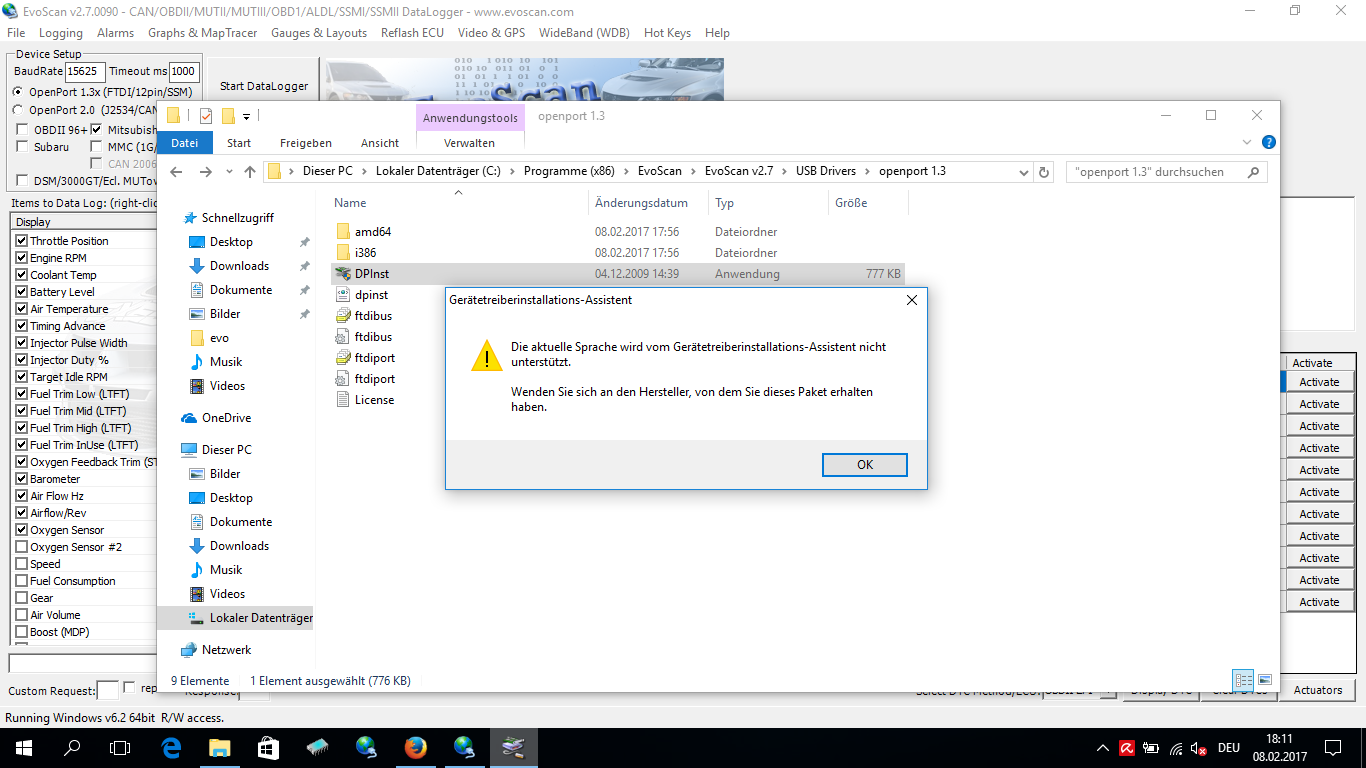

Thank you for your answer. Netframework 3.5 is installed, netframework 4 ... as well. I have already netframwork 4 switched off, but it was the same result ... evoscan I have already uninstalled and all drivers deleted and then reinstalled. Has nothing helped ... then I should try whether it works with evoscan 2.5? Thank you
Old Feb 8, 2017 | 09:17 AM
riraroli's Avatar
Joined: Jan 2017
Posts: 5
From: Switzerland
So I have now evoscan2.7 installed and tries to install the trieber, however came this message ... (the current language is not supported by the device driver wizard.
Contact the manufacturer from whom you have used this package)
I do not understand where the problem lies ...
This is problem with the driver package and the language you have Windows using. Change your default language to english in windows and try re-installing. Or you can try to get in contact with Tactrix and see if they will update the drivers to support your language.
