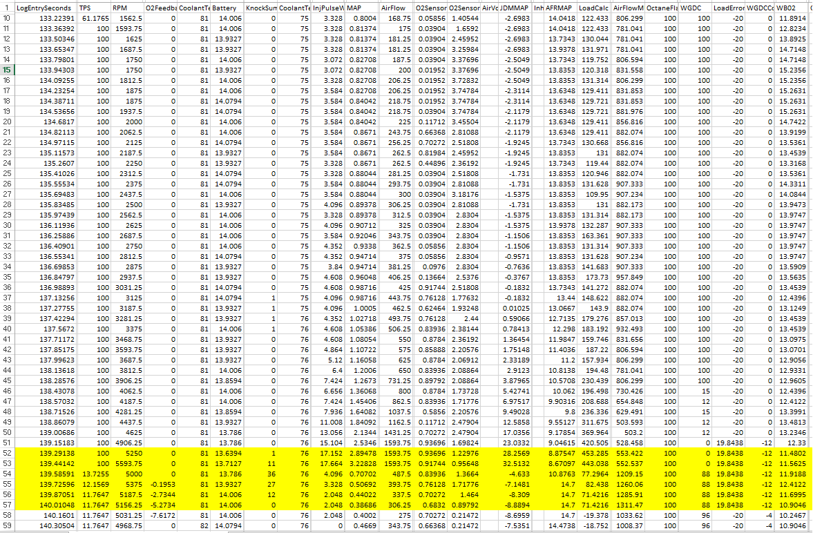

Thanks for posting the log, I've cleaned it up so that we can look at the relevant areas.
I didn't see a reliable MAP column in the log (unless it's pre conversion and I didn't pick it up)
I don't have a lot of experience in this area so I will wait for more people to comment, but here's what I can tell you from the log:
1. Your TPS sensor needs calibration, needs to be around 13.33 at idle, not 11.375 (Not relevant to the engine failure)

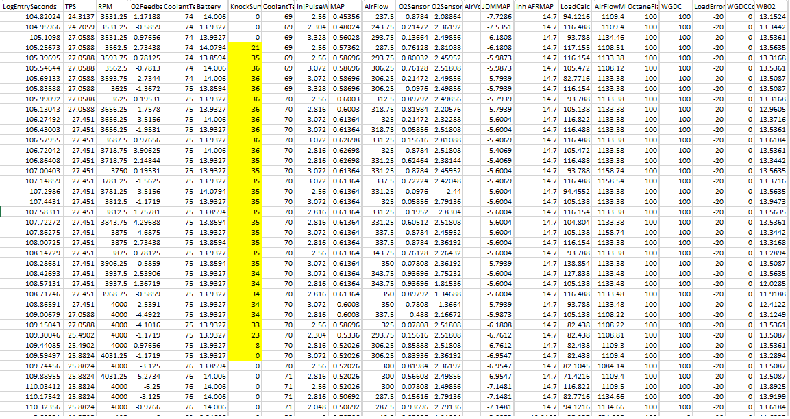

2. There were more than 20 counts of knock as the tuner was cruising to get to the pull even before the pull started. This would have raised a red flag for me (see picture below)
3. Your AFR MAP values, which is the AFR that your ECU is shooting for as it moves through the fuel map is a bit off from the real life wideband AFR reading. Some of this is to be expected from larger injectors..
4. During the actual dyno pull, your car seemed to run towards the lean side at the middle and top of the pull.
Despite all this, it looks like the car had issues before it hit the dyno. I say this because you don't just get 30 counts of knock during cruise unless there are other issues.
Cruise knock
End of pull knock

Thank you I appreciate the response and information. I was wondering a few weeks before I brought the car to this tuner I had my friend run logs and check them and I had very little knock and this tuner said he had to start from scratch for this tune because the previous tuner locked his map. does that mean the knock at cruise was due to his base map that he created? Sorry if this doesn't make sense or isn't relevant i am trying to determine if i am going to continue to allow this tuner to work on my car.

I've never seen knock at cruise, due to tuning. That would have to be a really bad tune. Really bad.
mechanical problem? Balance shaft flopping around?

Yeah. I'd agree that it could have been the bent/broken off balance shaft pinging around in the engine that may have caused such a high knock count and not actual detonation. It's unlikely that it was the base map from the tuner.
There is some good news to this though. If it's really just a balance shaft that came loose and the timing didn't skip, you still have a good block, good crank, good rods, and good pistons. You'd just need new rod bearings, main bearings, rings, hone and a throughout cleaning.

That cruise knock was likely just noise. The knock on the WOT was also likely noise. You can see the load go up around 4500rpm (turbo spooling) and the timing goes to 0*, which is good, and then it knocks, bad/a lot. Which also seems like noise, and the tuner comes out of the throttle. Something was wrong with the engine.
You stated it 30psi at 4500rpm with an FP red. My car makes almost 33psi at 4500 with 0* of timing. So you didn't get a torque spike. Even if you were on pump gas, this single event wouldn't have caused a failure. And certainly not the balance shaft to come out.
