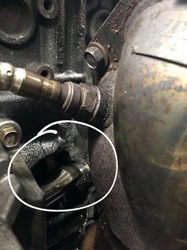

Just as an update. I haven't had time to mess with the car so it has been driven very little and today I took it to work (2 miles) and out of no where it through the crank through the block. Not sure why but I towed it back to the house and am disgusted with the car at this point.
Oh no!!
How do you know that's a crank (I can't tell by your photo)?
