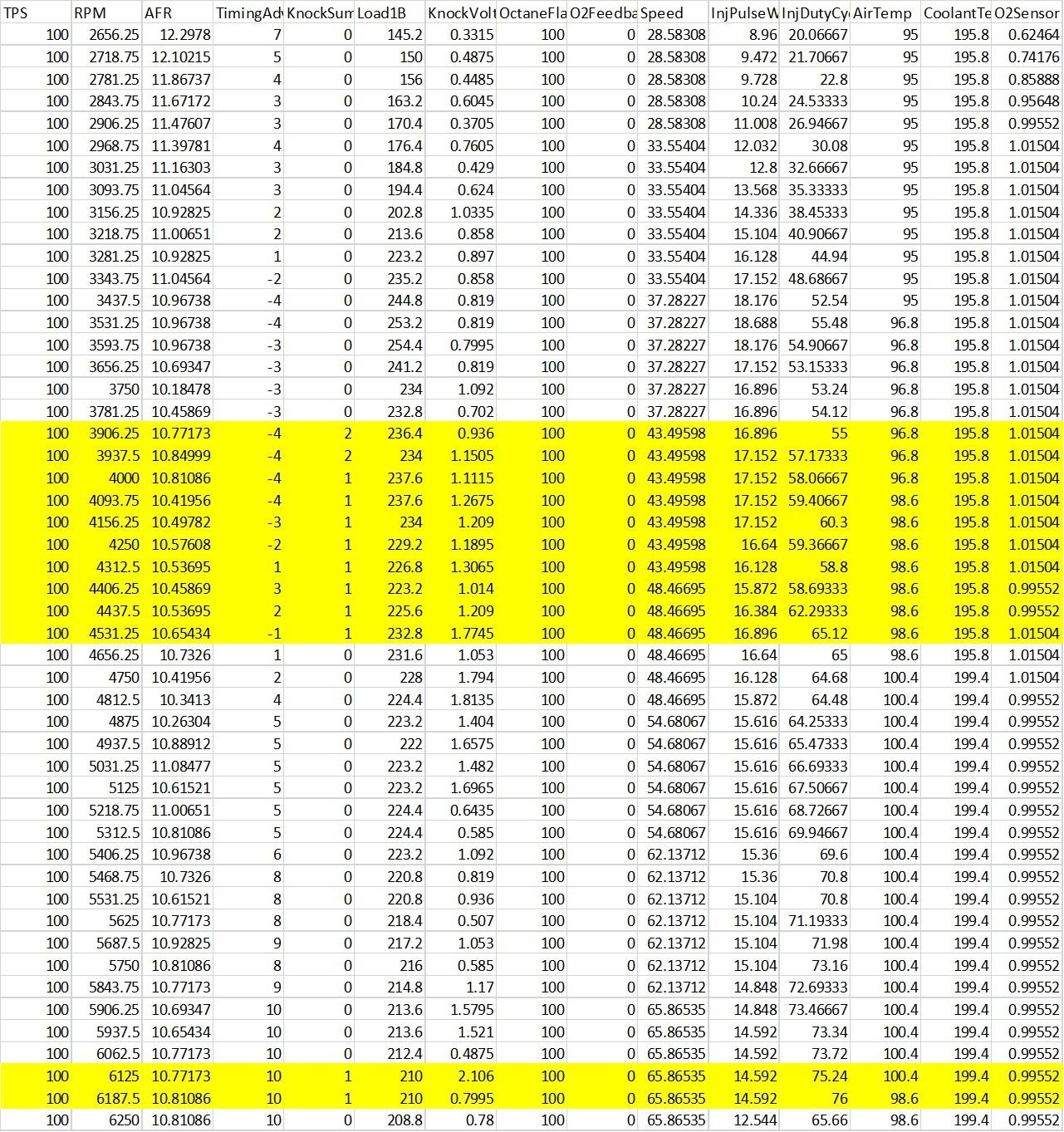

I own a mostly stock Evo 8 with HKS cams that I'm wanting to use for a lot of track days and as such I need as safe of a map as possible. I run 93 octane and have set my AFRs to all be low 11s to high 10s in boost and have basically started the game of retard the timing wherever it knocks. But now this is starting to get ridiculous in the 3000-4500rpm range where I have been chasing most of the knock and my tables are starting to look pretty different from what other people get away with at higher boost and boy does the car fall on its face.
Now the first reaction is that its phantom knock but pulling timing has actually helped, I was seeing 4-5 and even sometimes 6 counts before in cooler temperatures while now I never go over 2. I suppose it's possible that I was getting real knock along with phantom knock simultaneously so I poured in a bottle of torco (no race gas pumps near me) in 5 gallons of 93 and end up knocking 3 and 4 counts, figures.
Is anyone else having to pull so much timing to get rid of knock? Now I'm having to worry about EGTs from all that negative timing and the ECU still wants to pull more.
Keep in mind my timing table isn't smoothed out because I'm getting kind of frustrated and just change the cells I need to and go.

Went through my engine bay shaking on everything trying to find rattles, I did move my intercooler pipe farther away from the fan motor just in case. I pulled the spark plugs to take a look and they all looked normal, I had replaced them 4 months ago anyways. Then I went back to one of my earlier tunes that sits at 0 around the peak load area.
I had a good 3-4-5 pull with just a couple of 1 counts but at the time it was pulling a degree of timing on its own anyway in the mid range, I think I read somewhere that the ECU will pull timing if air temperature is high and its around 100...
But the second pull I did a couple of minutes later is posted below and looks way worse. At this point based on the conservativeness of the maps and my low boost settings I'm considering just tweaking the knock filters. My engine has higher miles so its quite possible my lifters are clanking up a storm.

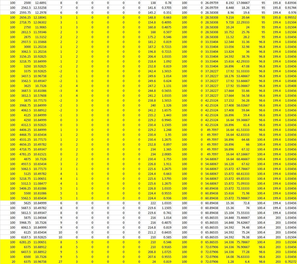

At the moment I just want to run stock boost with no knock.
If the rod bearings were ticking and registering as knock wouldn't I have counts continuing well into the upper rpms?
Mechanically speaking the engine is fine, it just has some miles on it.
Here is the stock map, as you can see the knock occurs in the same vein
Except it was way faster back then because the factory timing is so high and can only be pulled so much...
