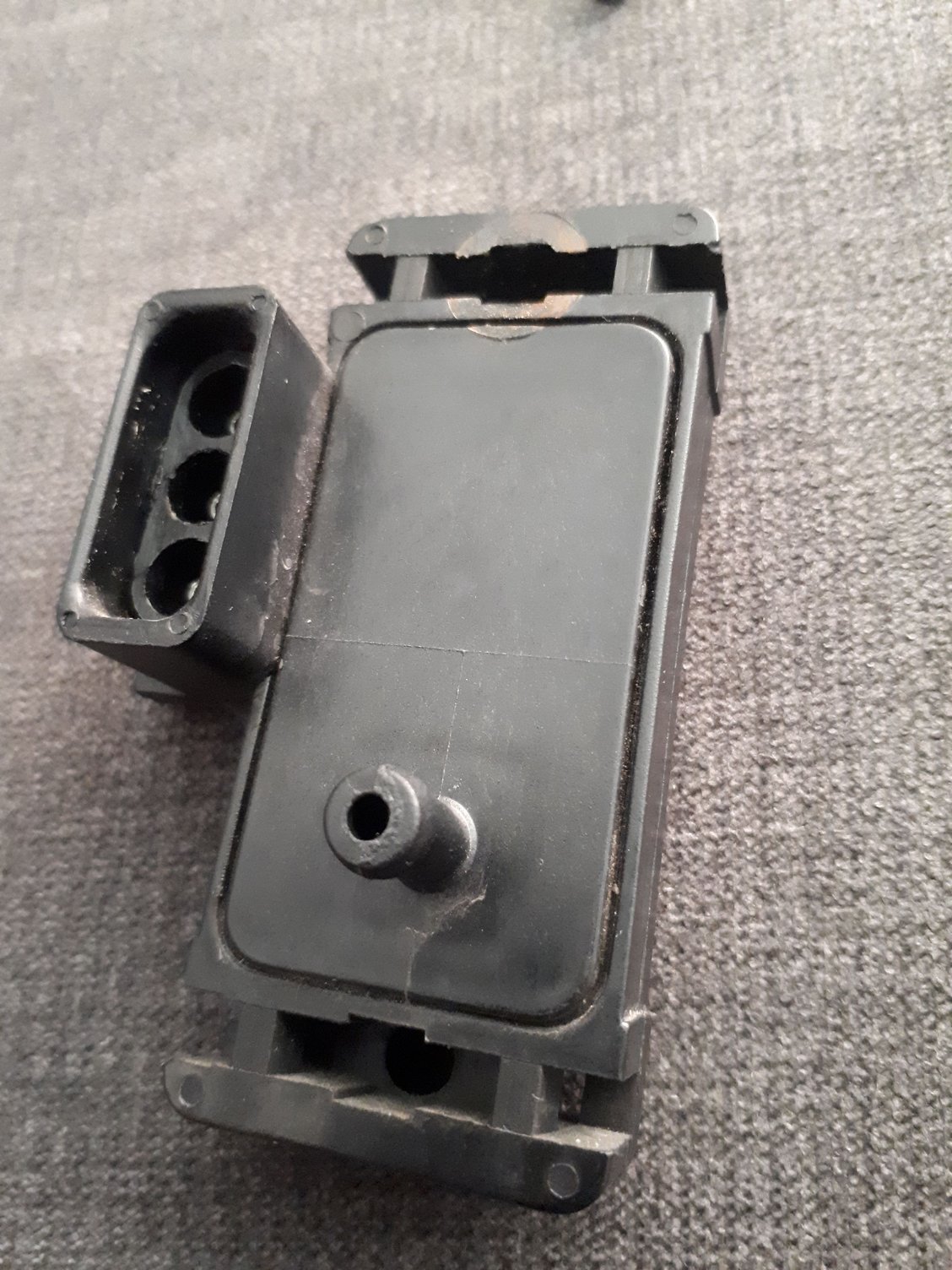

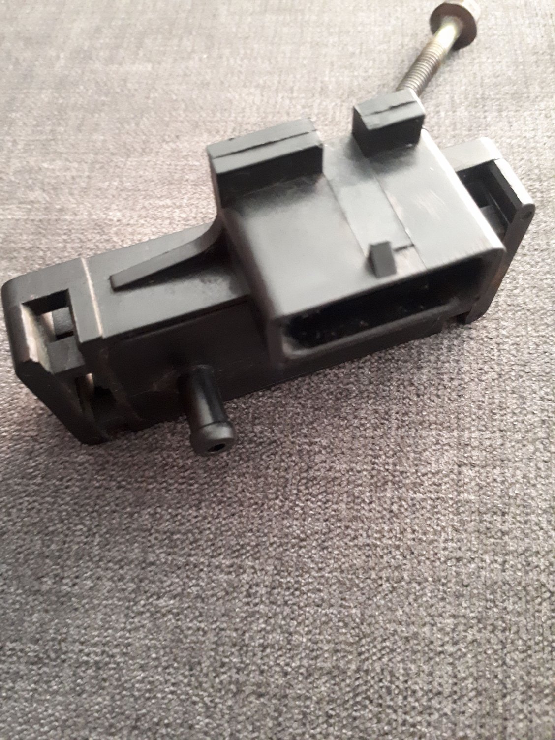

Hi I have a evo 8 and I'm having map sensor related problems I'm running speed density but unsure of Wat map sensor I require i have attached a picture below there's no codes r numbers at all on it

Looks like a GM 3 bar. Numbers on the back would tell us for sure if it had some, but I don't see anyone using a 1 or 2 bar.
Part # 12223861 for the 3 Bar.

It has no markings are numbers of any kind on it Would this be normal to use this gm part ??
Do they give much trouble?
Used to be fairly common. The Omni 4 bar has become the standard anymore.
