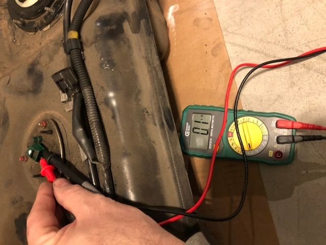

Has anyone had to replace one? What are the symptoms? How do I narrow it down?
I have to different tunes ATM. I have a speed density running off of AIT, and I also have a fuel temp sensor tune.
symptoms are different on each and lead me to the fuel temp sensor.
on the AIT tune I get a p0182 (fuel temp low)
on the fuel temp tune I get a p0112 (air temperature low) that will not clear while in that tune.
any input would be greatly appreciated.

So i believe the senor is located on the fuel tanl so it may not be accessible by just removing the rear seat.

Use the diagnostics process in the service manual attached.

Hey, just seeing this.
I haven’t gotten around to resolving this yet🤣
but I was just going to place an order for it tomorrow, and drop the tank.
ill try and give this a shot first for the hell of it. See what I come up with.
thanks
Old Jan 5, 2020 | 06:35 PM
dookgvr4's Avatar
Posts: 405
Likes: 13
From: Syracuse N.Y.
Dropped the tank..... confirmed the inevitable. Sensor is dead
