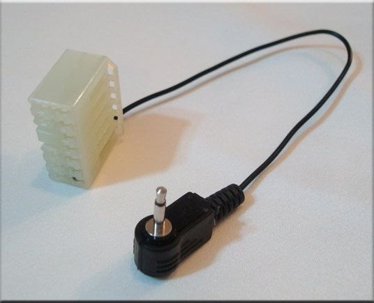

The 2nd one is the one with the jack. without it you cant write to the ECU. Mine is just the white plug tip with a very short wire. normally they stay in the car so people might forget to take that out when selling used tactrix adapters

Jul 11, 2023 | 01:53 PM
this is the simpler version of that 2nd adapter
