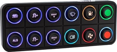

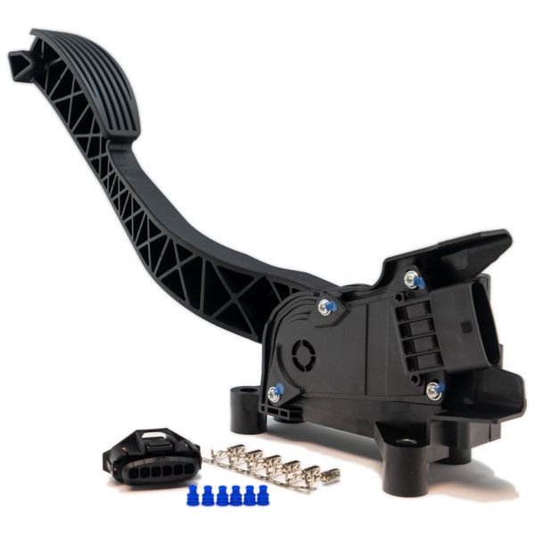

I'm on the Link ECU for many years now and I highly recommend it. There is plug-n-play model for Evo 9 so you just connect it and throw away old one. There are pre installed maps so you just choose your model and you are ready to drive & tune. I like the PC app - GUI is very clear and easy to handle. I dont know how to compare it to OEM ECU. Thats totally different beast. You just connect your laptop by USB and you are set in 10 sek. It let you make live tune with no delay. You can dump logs to further analyse it with other people.
They even produce e-throttle system or keypad with buttons that you can configure the way you want. Thats nice option if you messed alot with interior

What of the advantages of electronic tb and pedal?
what features do you like
the best?
how is the launch control and no lift to shift? I'm looking for more consistent 1/4. My 60 ft time is all over the place.

Electronic throttle can do cool stuff with how power ramps in even if the pedal is at 100% along with cruise control and some other stuff I think.
