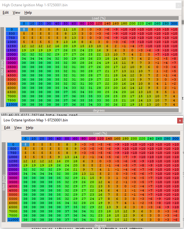

Hi there, Does anyone happen to have a picture of the Ignition Timing (Lo & Hi Octane) map for a JDM Evo 8 GSR engine.
I imported my Evo 8 a couple of years ago to the UK,
im converting it over to MaxxEcu Stand alone management with a 18 tooth trigger etc etc
i would very much like to see a STOCK ignition map for reference, I do not have the required cables etc to plug into my stock ECU. I’ve read countless posts on what seems very popular thread on here ‘Let’s see those ignition maps’ and cannot seem to find a picture of a stock set of maps, can anyone post a picture?
