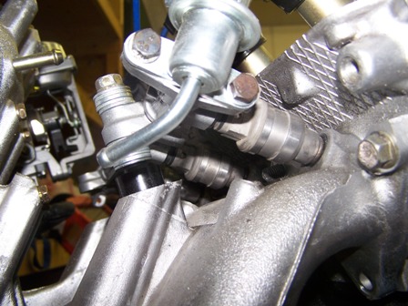

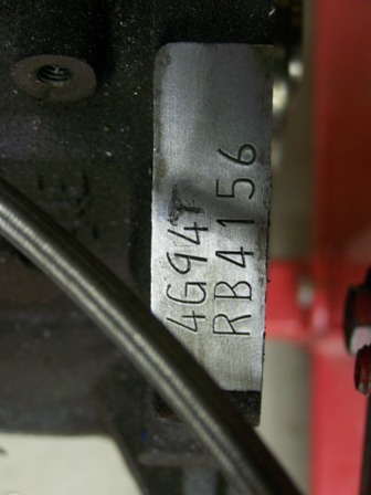

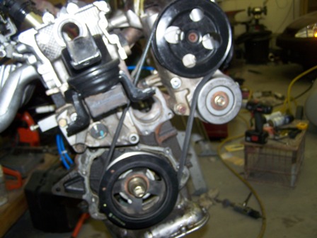

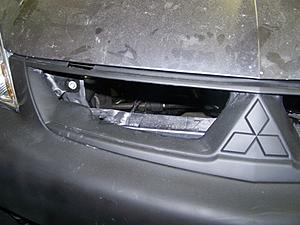

This is my Lancer Beast in the process of being built.
List:
Custom 3 inch Exhaust
3 inch turbo Intake Perrin Foam Filter
Evo VIII Intercooler and Pipes
Greddy Emanage and E-01
DSM T3/T4 Header
T3/T4 Turbine AR.63, Compressor AR.50
DSM 450cc Injectors, Walbro 255lph Custom Returned Fuel System
Wiseco Pistons
Pauter Rods
Aluminum Race Radiator
Ported and Polished Head and Intake Manifold
RRM Engine Mounts
Fidanza 4.3 Clutch
Attached Thumbnails Project Lancer Beast-3.jpg   Project Lancer Beast-4.jpg   Project Lancer Beast-5.jpg

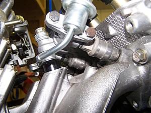

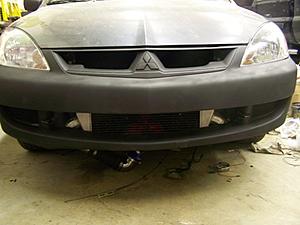

More Pics
Attached Thumbnails Project Lancer Beast-6.jpg   Project Lancer Beast-11.jpg   Project Lancer Beast-12.jpg   Project Lancer Beast-9.jpg   Project Lancer Beast-10.jpg

What maniold is that? Doesn't appear to be a re-flanged Evo mani...
Old Feb 8, 2008 | 11:59 AM
lncrphish's Avatar
Posts: 510
From: wichita
looks like t3 manifold. holes look redrilled. and the flange looks like it was cut between the last runner. but yeah what is it?
Old Feb 8, 2008 | 12:05 PM
lancer2show's Avatar
Posts: 1,643
From: newport news virginia
ya i saw this on my myspace..haha.
ya its a t3/4 manifold. nice build up btw. i ono if i could delete the a/c though...especially those hot summer days.
Old Feb 8, 2008 | 05:36 PM
lancerSE06's Avatar
Joined: Dec 2006
Posts: 56
From: Utah
its a dsm header.

DAMN!! How'd you snag an Evo XIII Intercooler?
Old Feb 14, 2008 | 07:14 AM
Kurt's Avatar
Joined: Jul 2002
Posts: 2,123
From: Maryland.
Nice setup. I look foward to seeing your car when it is finished.
Old Feb 14, 2008 | 01:20 PM

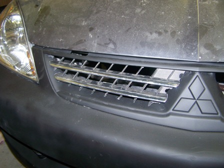

*Zero*'s Avatar
Joined: Jan 2007
Posts: 152
From: Phoenix AZ
did you just cut out the plastic pieces on your grill and paint it to get the crome off?
Old Feb 14, 2008 | 06:56 PM
lancerSE06's Avatar
Joined: Dec 2006
Posts: 56
From: Utah
Oops my bad.
