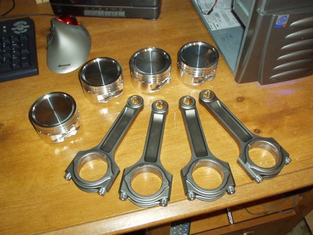

make sure you get some of these too =)

*drool* I need some of those

I got the intercooler from HartLancer, I have no idea where it came from. It's huge though, I looked all over it for a brand name I didn't see anything. The welds are ok on it, making me think someone with a clue made it but not professionally in a factory. If I had more disposable income I would have the rods and pistons already. Until then Im gonna run til it blows and then buy the good stuff. By the way its 1-2 weeks before it goes back on, college is killing me and the weekends seem to be getting shorter.

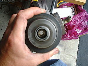

Some pictures from the rebuild.

Look at the extreme amount of carbon buildup, it took nearly a hammer and chisel to get it clean.

Cleaned of the carbon.

See the shiny new bushings in the middle? No more smokyjoe for me.
