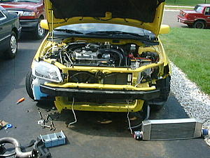

Old Aug 27, 2003 | 07:47 PM
airlinevomitbag's Avatar
Joined: Aug 2002
Posts: 995
From: Otsego Minnesota
Here I am minus bumper

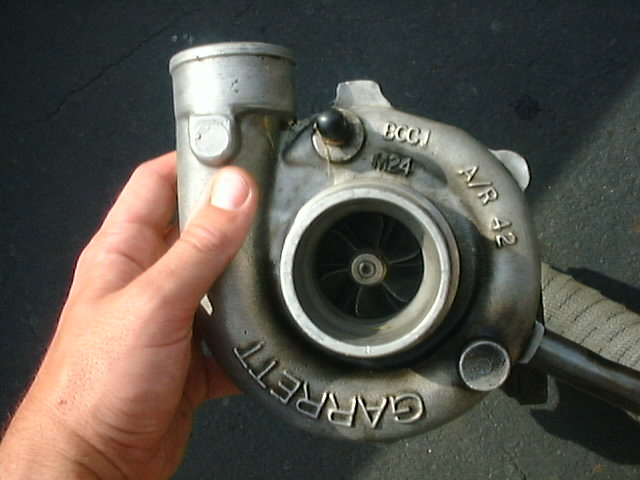

Old Aug 27, 2003 | 07:51 PM
Joined: Aug 2002
Posts: 995
And the turbo up close

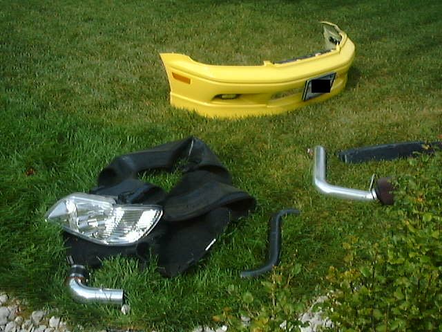

Old Aug 27, 2003 | 07:55 PM
Joined: Aug 2002
Posts: 995
The junk all over the yard
Old Aug 27, 2003 | 07:56 PM
4G63_Attack's Avatar
Joined: Mar 2002
Posts: 199
From: Los Angeles
what size turbo is that ???
T-3 I dont understand the trim and stuff thats why I posted the upclose pic of it with the numbers if someone wants to elaborate.

Old Aug 27, 2003 | 08:12 PM
bahamut's Avatar
Joined: Apr 2002
Posts: 2,167
From: TB, FL
On your TC mani, you might want to grind a bit of metal slag off. I'm just being picky.
As for the TC, it's a .48 AR trim. It's probably a similar trim to a T25 on a 2g DSM. Spool up quick.
A G93 TC mirage w/ a turbonetics T3 60 trim spooled around 2500 rpm. This turbo is bigger than the two above. HK, if correct, has a T3 S60, which is even better flow that the mirage.
