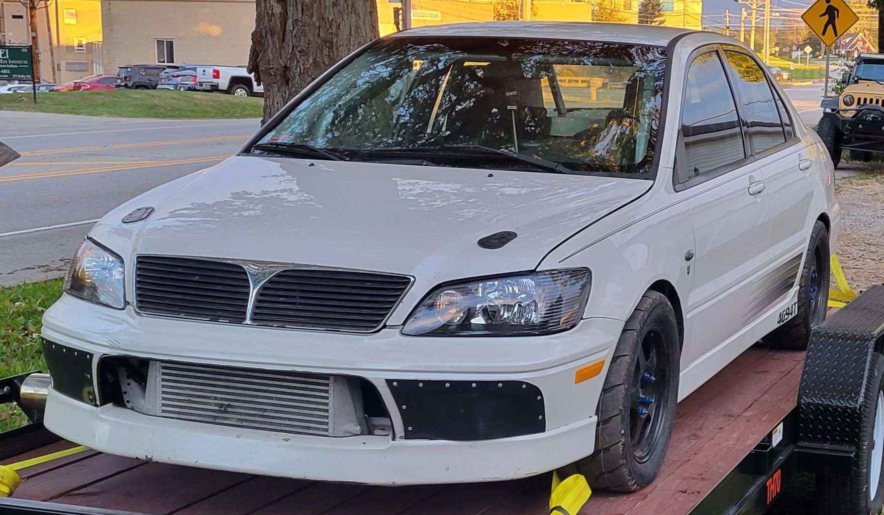

Update pics, car came out with the 4g63 and did alright for about a season the JDM had internal damage and ended up needing rebuilt. Built a 2.4 for the car and just recently had car tuned she put down right at 700 on a mustang dyno "AWD" before she ran out of pump 4303/ID2000. Going to start building the next engine but will hopefully get some 1/4 miles numbers out this year. If anyone has the VIS CF hood could you please weigh it for me trying calculate best weight reduction vs price.
