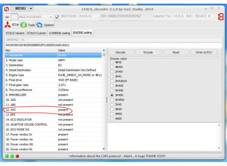

Took me a lot of digging before I got to this...
After reading the thread about disabling TPMS with
Lexia Lexia
using
DiagBox or ETACS Decoder - best ETACS management tool ever!
I've found a screenshot of ETACS decoder on their website. Disabling ASC theoretically should work. I would contact Vadimus (one of the guys behind ETACS Decoder) and ask if he can help you with that. Another option would be to ask a dealer to disable ASC.

So I went to dealer this moring. U0121 fixed!!
I will post a How to shortly.
