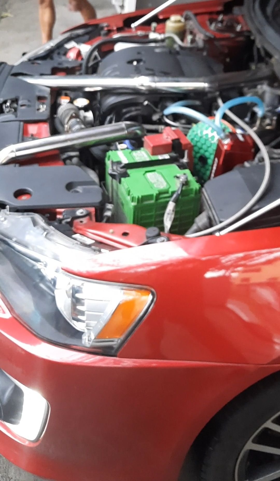

Hi iam just finished adding a turbo on a '17 lancer gta and having some problems.
Rough idling even if i drove it for an hour to relearn the ecu, also it has a cel codes p0068 (maf, map, tps correlation) and p061a (torque monitoring). The ecu is not flashed yet. Anyone with experience could chime in. Thanks
heres the pic of the engine btw

You need to flash a basemap on your ECU with a turbo map or use a RA/Evo X ECU with a map. How do you expect a NA rom to function with a turbo setup. Hit up HTuning on Facebook and we can set you up.
