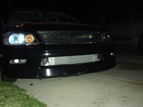

just installed my evo8 intercooler, just wated to say NICEEE!!
bolted up no problem, the evo and lancer have the same frame =)

Nice dude. Looks sharp. Always love to see custom work.
How was it routing the piping? Extreme bends in the piping or no?

Glad to hear it bolted on! Where exactly does it mount up?

wow from what ive always heard, the evo8 ic was too big too fit. nice work, whered you ge thte piping done?

It looks too restrictive behind that bumper. Looks clean... Anybody needs an OEM IC? Will have mine for sale soon.

i dont have the piping done yet, i just had the ic fitted. i plan on getting a new front bumper and rear bumper soon. im getting the piping done at a local muffler shop saturday.
the stock 5mph crash bumper had to come off, but i have a feeling that a evo one would fit.
the two side bolts mount where the 2 rubber drums mount, the top mount needs a bracket made, eh, but it fits =)

how much extra boost can you run with the upgraded IC?

i could probably max out my turbo.
