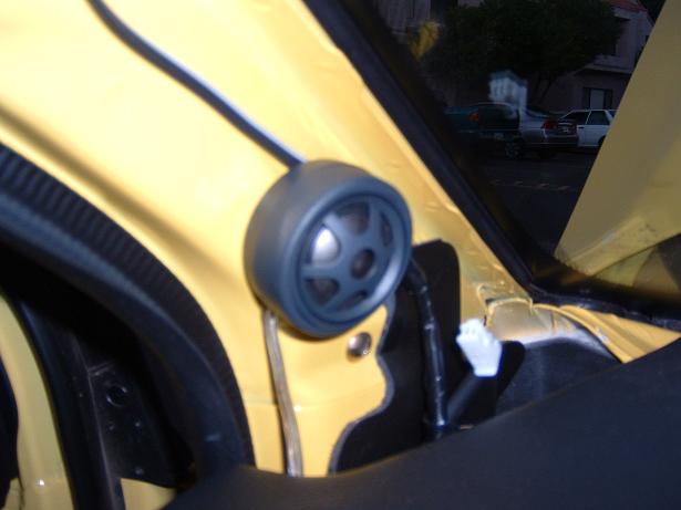

the size folks is euro-din (7"). i tried every single 6.5" there was & none of them fit EXACTLY like stock. so i made baffles for my components & trimmed the inside of the door panel. sorry the pics are a lil blurry. it was raining outside when i installed them. here are a couple pics:

what i mean by baffle is the wooden spacer between the speaker & door. i did have to trim the inside of the plastic on the door panel i removed also to allow for the extra clearance. they way i measured this is i 1st measured the mounting depth of the stock speaker to determine baffle thickness. i then cut baffles to exact shape of stock speakers, test fit (by rolling window down) & proceeded to bolt it in. i also used the stock speaker as a template & even took the stock speaker into all the car audio places showing them that what they sold was too small. yes it is true the actual driver itself is 6 1/2 but the entire speaker mounting points (hole to hole) measured 7" (170mm). good luck & let me know if you need any help!
