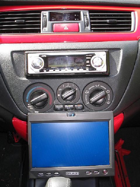

just incase anyone still wants to know i have done this

Yup...mine looks similar, but I fiberglassed the whole piece to match my interior.

Doesn't the screen get in the way from all the gear shifting?

not at all and it doesnt really block the screen either i like it there angles arnt hard to see it

I have one there as well. No problems. Just get the relocation kit.

well for me I didn't use the relocation kit. I just had it cut and fiberglassed (don't know why I didn't use the kit). The thing with mine is that I can't have the screen out and in park at the same time. So what I do is when the screen is up and I'm watching it, I put the car in neutral and put the e-brake on. A little inconvenient, but it works...=)

looks really good, but now makes your lancer more prone to being broken into. hopefully it wont happen though.

ozmaster they make special wiring to bypass that
