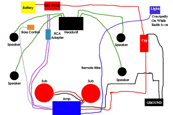

Old May 22, 2003 | 03:03 AM
japandk's Avatar
Joined: Mar 2002
Posts: 39
From: Milwaukee
Diagram
Hope this helps.
Edit: This finally makes me an evolving member.......!!!!!!!!!!!!!

Yeah, thx Japandk. That's what everyone seems to be telling me. Im gonna be doing this setup when i do my custom box for the trunk. Thx for ur help guys
