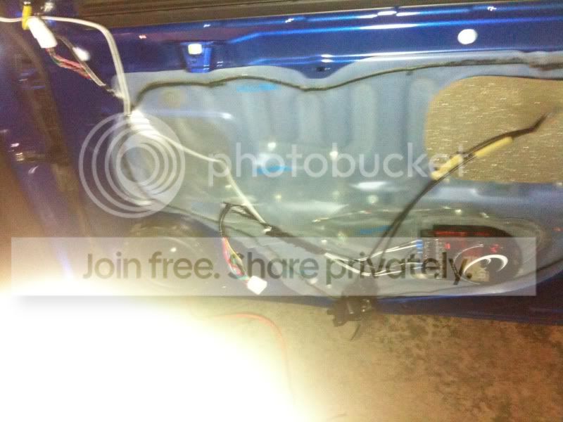

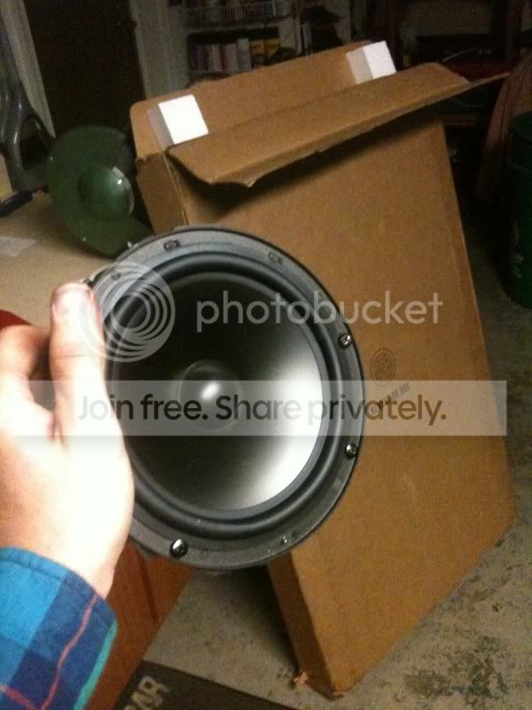

JL XR650 Components for the front\
JL XR650 Coaxials for the rear

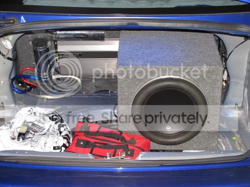

1 Sealed W7 12 inch :ymdevil:
1 JL Audio 500/1 Mono Amp %-(
The Veins of the operation:

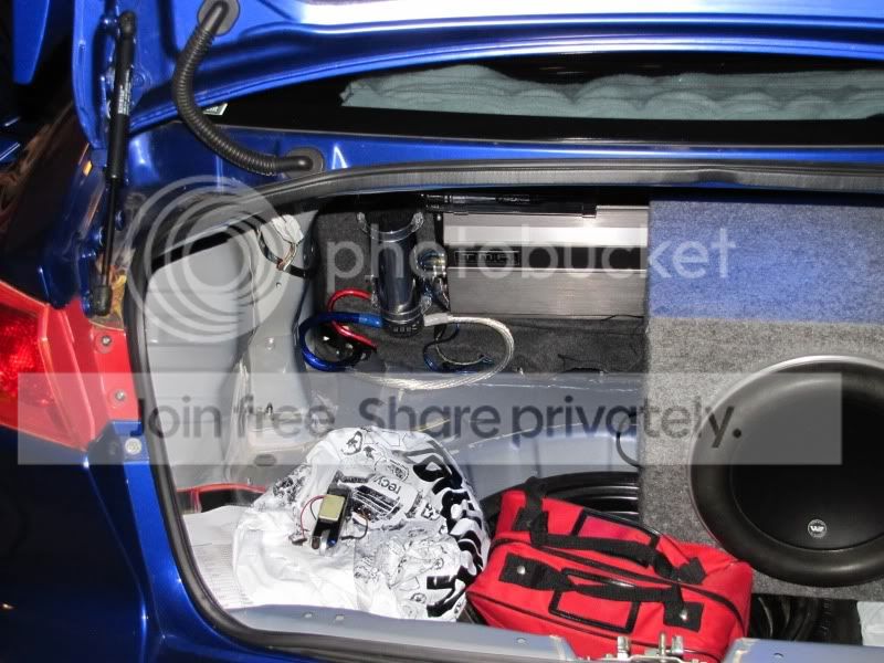

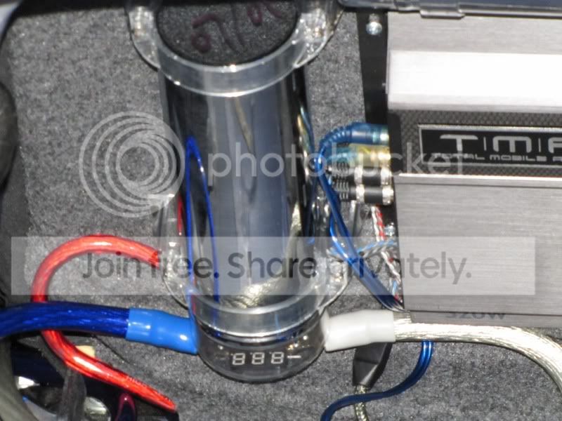

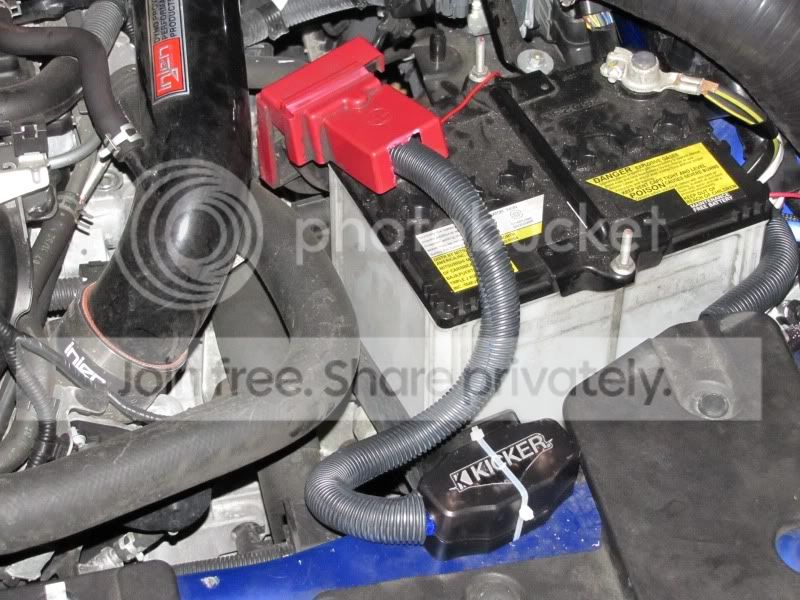

0 Gauge Wiring To the 2 1.5 Farad Tsunami caps and O gauge to the cap ground.

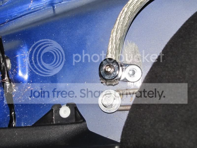

Ground is hidden under rear seat for clean install ^^

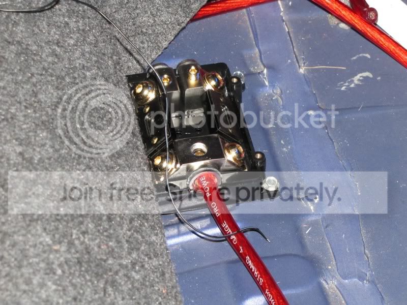

Then 4 gauge from positive cap input to Power splitter that splits 1 wire into two seperate 250 amp fuses to seperate outputs.
Each amp has its own ground
The "Cleanliness":
As pictures will show i did the cleanest possible job (especially with 0 gauge mammoth wiring)
I spent 8 hours rewiring everything.

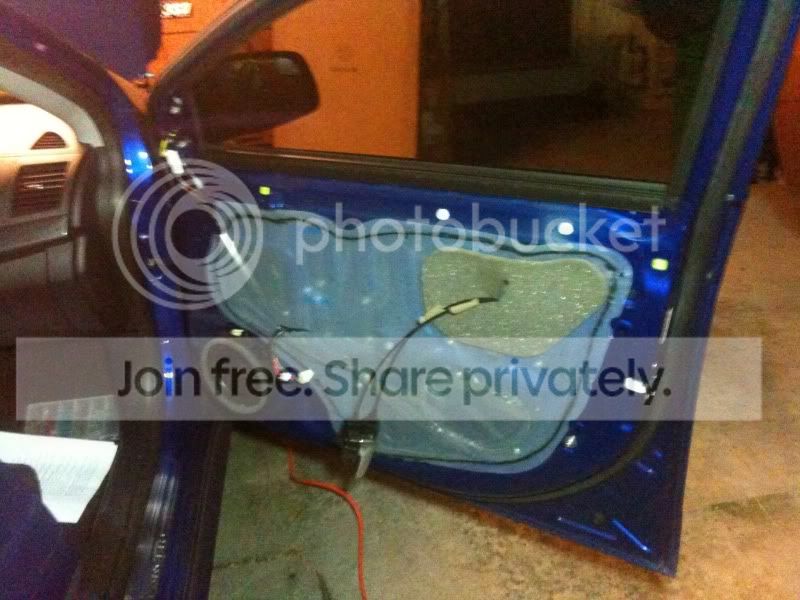

Took out stock amp and ran my signal and 9 wire cable from under the stock amp location in the carpet through the middle of the car under the carpet and up under the backseat.
Power wire was run on drivers side. (thus the reason for running signal and speaker through the middle to eliminate noise.
All excess wire is zip-tied and hidden neatly under rear set and as stated before the ground is on the drivers side on the far left
trunk is far from finished and stick have to cut out new wood piece
but updates will be posted

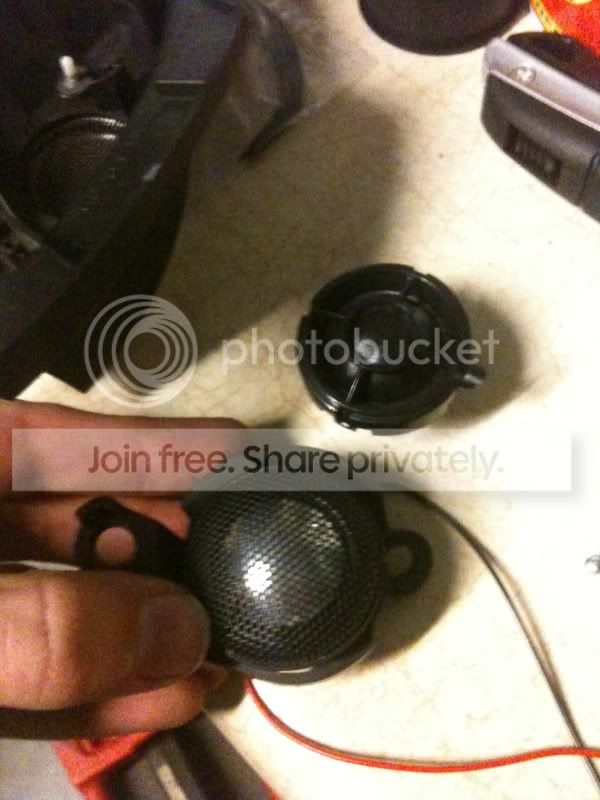

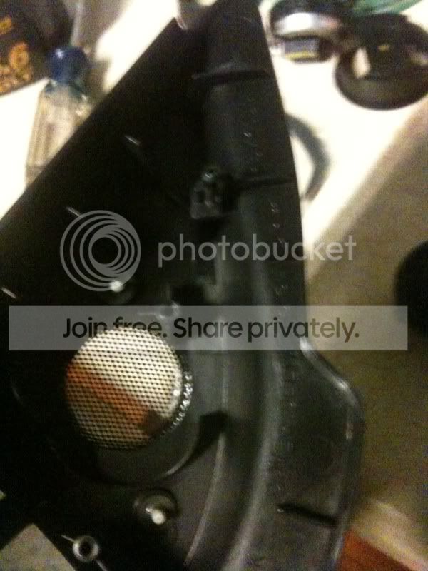

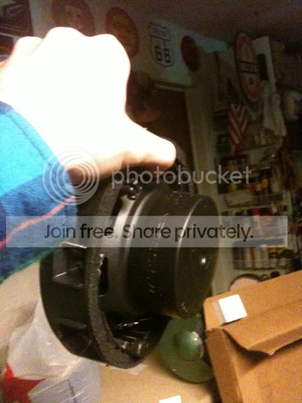

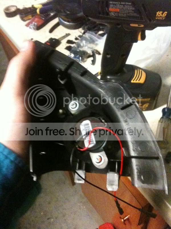

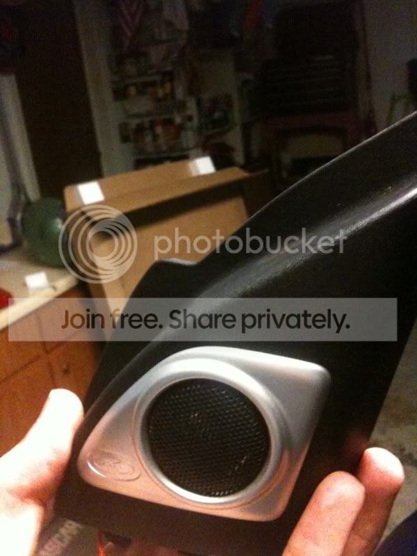

also used stock tweeter pods and was able to fit the aftermarket tweeters in =)(RRM took their sweet time with my CF ones and i have a short patience)

tweeter pods!!:
top are rockford and bottoms are my JL
i also covered the rockford symbol with the JL symbol that was meant for the grille but i stuck it there instead

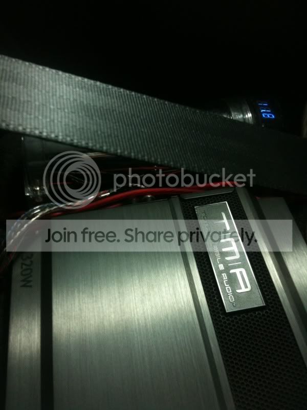

TMA 320.4 4 channel (wire tuck tmrw):

lol you definitely dont need 0 gauge for a 500 watt amp and 320 watt amp.....i was running all 4 gauge when I had my 1600 watt L7s and no cap either.....where did you run the 0 gauge from the battery to in the car?

Well my 4 gauge was burnt and why not just go all out

well 4 is a lot cheaper lol

I paid 100 bucks for a full 0 gauge kit with the power splitter and for a jl audio bass knob
