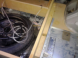

braced trunk frame with 1 x 1, glued with screws vertically and horizontally. strong as hell
Custom 'carputer' fabrication // car audio build thread-ad9hq.jpg
Custom 'carputer' fabrication // car audio build thread-rylgf.jpg
Custom 'carputer' fabrication // car audio build thread-0zyjj.jpg
