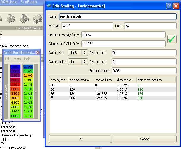

BTW this is what my accel enrich looks like...what do i need to change?, i have alot of accel enrich settings as you can see here:

Oh, the Async Accel vs RPM table, that one is the "accel enrich" table I'm talking about. It appears to be of the "stock lancer" variety on yours, as it's thick up top, then drops down quickly by 3000 rpm. The Evo one starts low and climbs quickly by like 3000 rpm....so I dunno, right now we have steven using the evo table, and 03lances using the base lancer "i think"...I've got stock lancer, and it's too lean as a "stab"....Bleh.
I guess I'll see tomorrow morning what the dill is, but let us know 03lances what yours currently looks like, if you don't mind.
The only thing I found as far as forum posts go, is that accel enrichment displays the value for the RPM range as long as RPM's are increasing. I'm thinking I might be excited tomorrow morning, if it helps. Perhaps maybe a mix of the stock lancer and the evo table?

I can say for sure I am using the stock accel enrich for the base lancer as I changed it Back rather recently from my own mixed values I had in there. Now that doesn't mean using others is a bad idea there are lots of variables so switching to the evos might work for you.
Mitsukid since your rich now maybe try and cut those values in half now so if you raised them 10 drop them all down 5 and see what happens. If you had. That much of a change just switching the mag values then we should be able to get them closer using the maf table then fine tune certain areas with other tables such as that accel enrichment

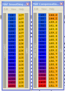

Also, attached pic....I think MAF smoothing/compensation may have some effect as well, since if you notice the drastic reduction at about 600 hz....where I jump into boost, or right before. I'm going to copy the "scaling" over to mine this afternoon, like use the same percentage changes and see how that works out.
