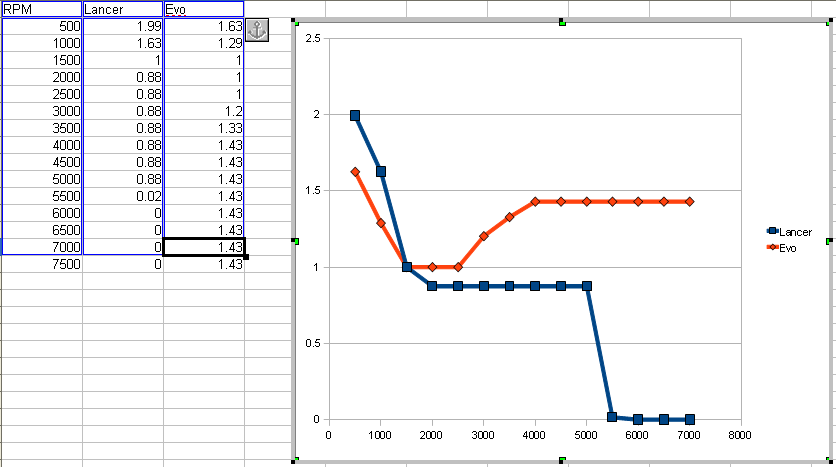

It looks to be, but like I said I'm no expert. Here's why I think I should adjust accel enrich. This is a graph of the 2 different enrichment tables, and it looks like the evo's really kicks off in boost. You'll still probably run lean, just FYI. But at least you won't see that rich knock, and can slowly adjust upward if you want to thick'n her up a bit.

Ok, so i should adjust the values from say 2500+? Also what do you think is up with the random 42, and 18????

That accel enrich is wrong. It's a different table, don't adjust the one vs RPM adder....I just looked again, and it didn't make sense.
