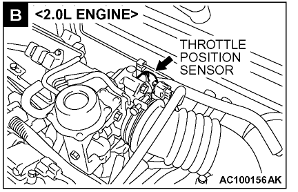

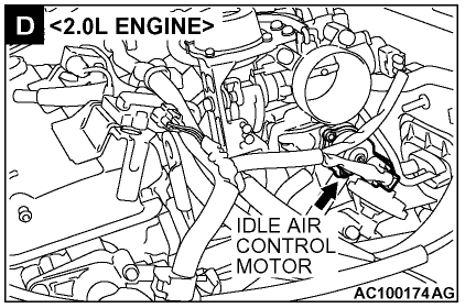

Here are the locations for both.
Attached Thumbnails 02 OZ Rally Auto Question-107297980.gif   02 OZ Rally Auto Question-107307423.gif
