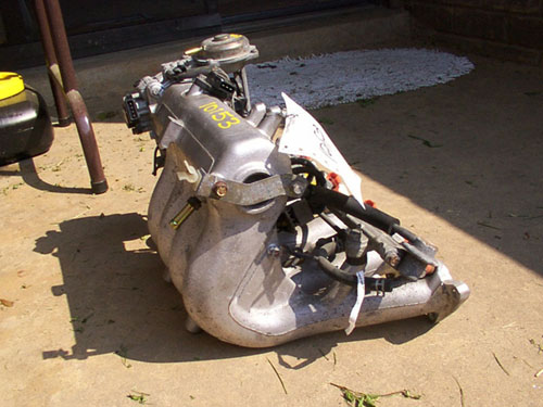

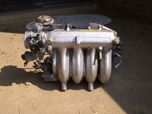

I got 1 nice surprise today, and another big bummer. My dyno run was rescheduled for tomorrow because the shop was running behind . The nice surprise was I got my 4G93 manifold via UPS. Now that's not really the big surprise. What was shocking is when I opened the package I see that they sent me EVERYTHING: manifold, throttle body, fuel rail, sensors, injectors, hoses, clamps, etc.
So, what parts can I use on the Lancer? Could I send the injectors out to get enlarged? The fuel rail looks the same. The throttle body looks smaller, and has 4 connectors on the TPS when I think we have 3. Any ideas?

wow, how much did they sell it to you for? you could go get the fuel rail bored out. as for injectors and TB, i wouldnt know.

Bore out the fuel rail......... now u have a RRM BIG Bore fuel rail... for less than 100$

Ha ha, I told a few people in some other threads how much I spent. Let's just say I spent less on this entire thing that a RRM bored out fuel rail.
It doesn't look like the TB will be swappable nor portable. The valve is pretty small to begin with and the walls are pretty shallow as well. I'm going to go out to the Lancer right now and examine some things to see what's what.

You wont want to use back most of those parts.... for example, the stock 4G93 TB is only 50 mm, which is smaller than the Lancers. The injectors are also smaller, at 210cc's. You can see if you can sell those as upgrades to 1.5L Miragers. That would be your best bet. I actually have a friend that uses the 4G93 TBs and bores them out and adds a buigger butterfly.... cant remember his price, but he should be able to do that to Lancer TBs as well. That way, you get to keep your cruise control, unlike myself, who has been driving around for YEARS without cruise control. Does suck sometimes on long trips, but that is the price of power.
