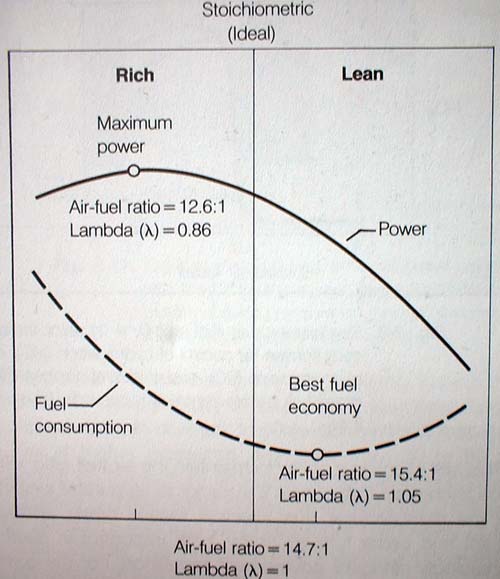

mmmm, a leaner afr is okay for na, but the strength of higher octane comes from advanced timing. here's a basic guide on afr from bosch. due to engine design(cooling efficiency, combustion chamber design, etc.) different afr's and ign timing will be different between cars. everyone has their tuning philosophy. kinda like how some tuners will take the 5hp fall on a turbo setup by doing 10.5AFR than 11.5AFR for safety's sake. our cars could possibly make better power going leaner na.
(i need a scanner)

Rhyzin, "the strength of octane comes from timing" is kinda what I thought. Back to tuning with timing Thanks
