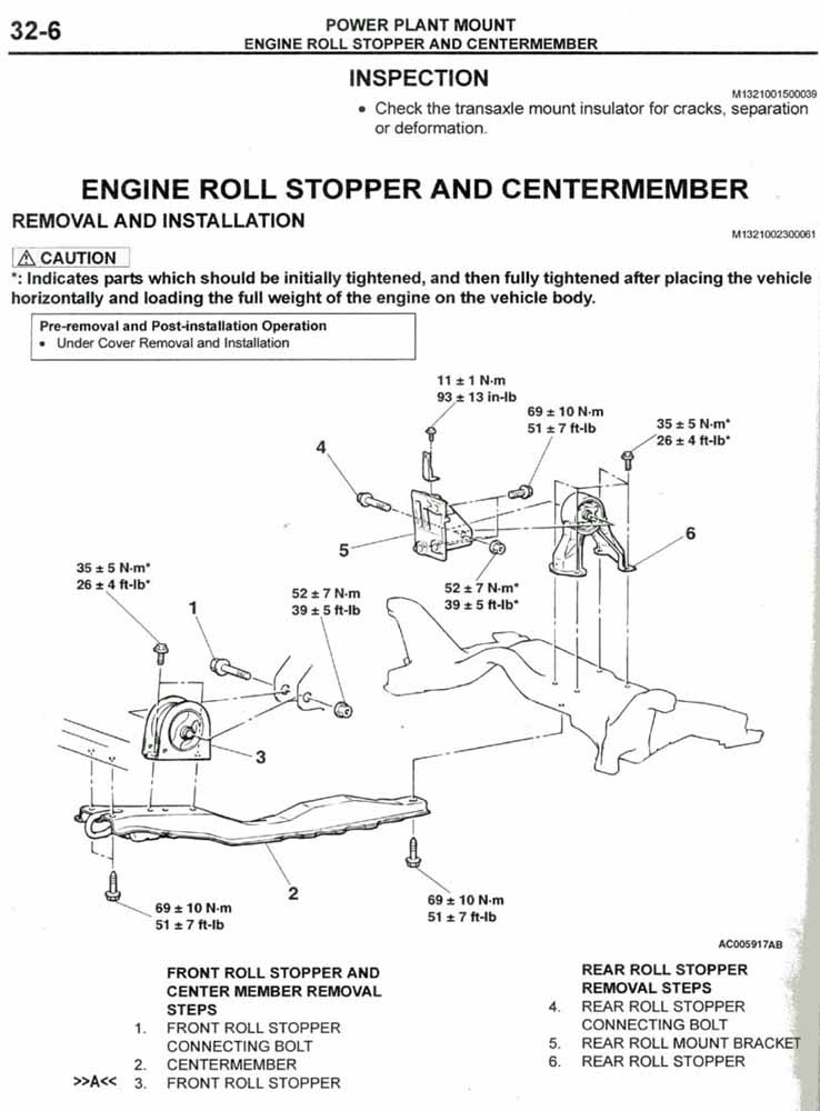

Originally Posted by Handmemyarms
ha, awesome, yeah having someone there showing me how to do it would be the ultimate plus.
you need somebody to show you how to do it? it's simple. hopefully this will help:
Attached Thumbnails How hard is it to installmotor mounts?-motor-mounts0001.jpg

thanks for the pic comatose
