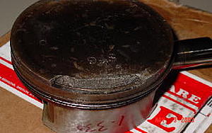

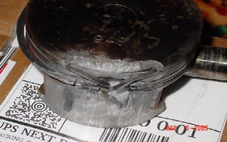

This is what will happen to your pistons if you run too much boost on your turbo. Please do not add synthetic oil when you get a turbo kit this is what can also happen

piston #4

and piston #1

all i do is run synthetic oil...i have no problems......also what boost was that at?

That sucks, NTran. Also curious how many PSI. Who claimed the oil was a factor? That seems rather silly to me.

damn...thats major suckage... yea what boost? and under what conditions did that happen? racing? normal driving?

8 psi and racing a supercharged mustang. Well Rob told me not to run synthetic and i guess i forgot

oh well i've been at 8 psi for over 6 months now and i don't have any problems with my pistons. i wonder why Rob would say not to run synthetic......

I have an automatic and no intercooler

ohh yes the no intercooler will do it
