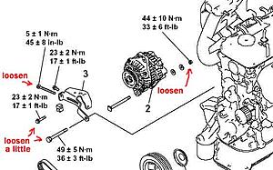

I'm still needing specs on the water pump bolts, belt tensioner, and the crankshaft pulley bolt. And if there's anything additional I'm missing, please let me know!
In exchange, I'll attempt my hand at a DIY belts change thread. Just a little give and take...
Thx
Attached Thumbnails Torque specs request for tomorrow's belts change...-alternatorloosen.jpg

^Yeah, at least someone commented! LOL Funny, all I could find was this pic and belt deflection rates. But nothing else...
I know some of you have a service manual, so plz help a brotha out!
Water pump bolts : 17 ft*lbs
Belt tensioner : 17 ft*lbs
Crank pulley bolt : 134 ft*lbs
