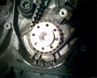

what year is your oz? I'm guessing probably the 02-03 model and also, how many miles?
well, if you have the 02-03... here is the diagram.

ya man, stop driving your car and change the belt asap.. my belt on my 02 went around 10-15k before yours!
I lucked out and didn't have any valve damage as my car was parked and running when some of the ribs gave out..
but there is not enough valve clearance to save your motor if your belt gives out. You will be stuck with bent valves and that's a lot worse than just replacing the timing belt.

When down there, make sure to clean the Crankshaft position sensor...you can make it out a little in that provided pic. But my car decided to randomly not start and that WAS the cause. Brake clean and a shop cloth made quick work of that while in there doing the T-belt change.
Thanks for the heads up, I'll do that too since it will be all apart.
