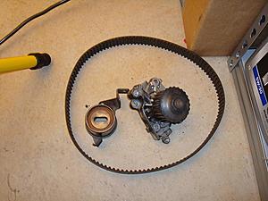

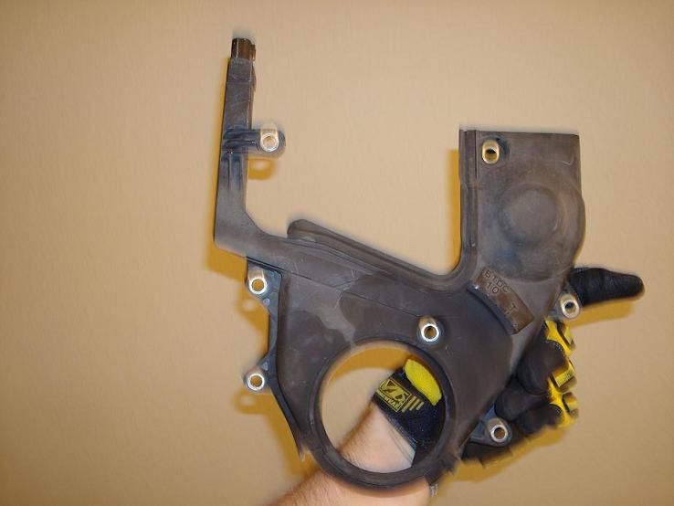

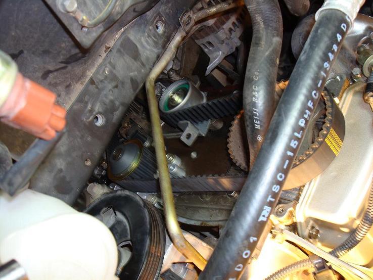

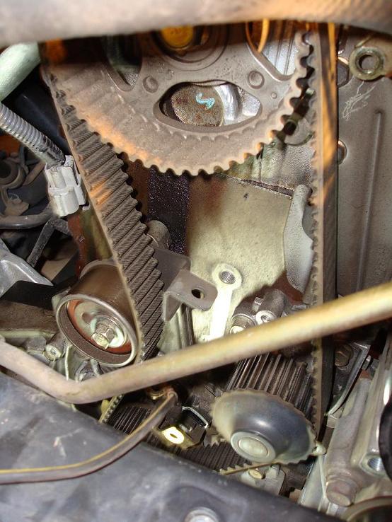

Hey guys, finished up the timing belt install. I went to Sears and bought a Craftsman 26 gallon air compressor for $288 and it came with a set of air tools. I also purchased a set of impact sockets for about $90 (needed a 22mm and no other set that I could find had one this size, and I couldn't find one by itself in that size, either). Unfortunately, the 1/2" drive air impact couldn't break loose the crank pulley bolt, and thats when I realized it was only rated at 200 ft lbs of torque. I went back to Sears and saw one rated at 300ft lbs for like $40, but for around $80 I got one rated at 400 ft lbs. If I were to do it over again, I would have just purchased the bigger compressor (33 gallon) for the same price as the 26 gallon, only it doesn't come with the air tool kit. Live & learn I guess.
Anyway, the impact rated at 400 ft lbs broke it loose in a split second and following the step by step instructions from mcgarvey, it was pretty straight forward. I ended up spending about $100 more than the dealership wanted for parts and labor, but I have some kick *** new tools for the garage to show for it. (not to mention the knowledge I gained from doing it myself)
Oh yeah, that 106k belt looked almost new! (Wasn't missing any teeth, just had one worn spot on the outer edge)
I don't know if there is a limit to the # of attachments I can post up here, but I took some pics for those of you that were contemplating doing it yourself.
