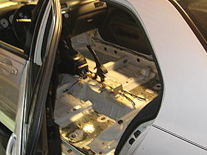

Nice name there^ Just strip all of the interior including rear seats. Every little bit will help.

Yah I am trying to make the car look stock from the out side so I am going to keep seats and all door panels But what I did was pulled the carpet up and took off all the backing to it and then removed all the sound deadener from the rear Once I get GOOD Tires I will remove deadener from the front but trying to leave some weight up there. pulled a door panel off and well there not much of anything behind it for my to really remove pulled the small metal bracketing from were radio use to be (I have RRM radio relocater and center gauge pod.) And cut the heavy black rubber pad from the passengers side. Still have all the work to do on drivers side.

While my transaxle is blown might as well use the time to cut some weight. Pulled carpet and started removing sound material. Also the carpet in the vehicle is the heaviest carpet that I have ever used going to go to Wal-Mart and get some of their cheap stuff. Weight loss-img_4364.jpg Weight loss-img_4366.jpg
