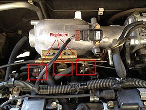

So far I have replaced;
- Vacuum Control Value
- EGR Vacuum Solenoid
- All Hoses
I have removed and cleaned the valve and tested it. It seems to be working properly.
Where is the DPFE? Anyone have a picture for the Lancer. I believe I have also replaced it since I replaced the entire EGR system (excluding the valve).
I have attached pictures of what I have replaced.. just in case the terminology isn't translating.

Im starting to wonder if we have a dpfe as I cant seem to find any refrence to it in the fsm. Did you check your harness clips and/or harness itself for possible breaks? This seems the most likely culprit considering the steps you have already taken to resolve this. In response to your other thread about disabling the system check you can use ecuflash and disable this in an evo rom. I am not sure if there has been enough disassembly done in the stock base lancer roms to disable this.
Old Nov 26, 2011 | 10:33 PM
MagnumVP's Avatar
Joined: May 2010
Posts: 26
From: CA
Harness? Are you referring to the all brass looking metal that the solenoid bolts too? If so, yes. I replaced it with the new EGR system. The entire package came with hoses and the entire metal harness.

I mean the actual electrical plugs that connect to the solenoids in that area. maybe a bent or broken pin in the plug is causing your issue. You have the evap purge solenoid and the egr solenoid both right there.
You could always use the old carb cleaner trick. Spray carb cleaner around all the vacuum lines and listen for a change in rpms. If you find a spot where the rpms raise as you spray then you have a leak in that area. Be careful if you use this method though there is a the remote chance of setting your car on fire lol.
Originally Posted by MagnumVP
In regards to the DPFE, when I did a search just for a replacement part at RockAuto and other places I don't see any reference to it either. "Googling" if as well doesn't produce any references or pictures for the Lancer.
Yeah in wondering in the vacuum control valve is what we use instead of the dpfe possibly.

the MAP sensor is used to detect whether the egr is open or not. Its that thing on top of your intake manifold with the harness coming out of it that leads to your injector harness.
