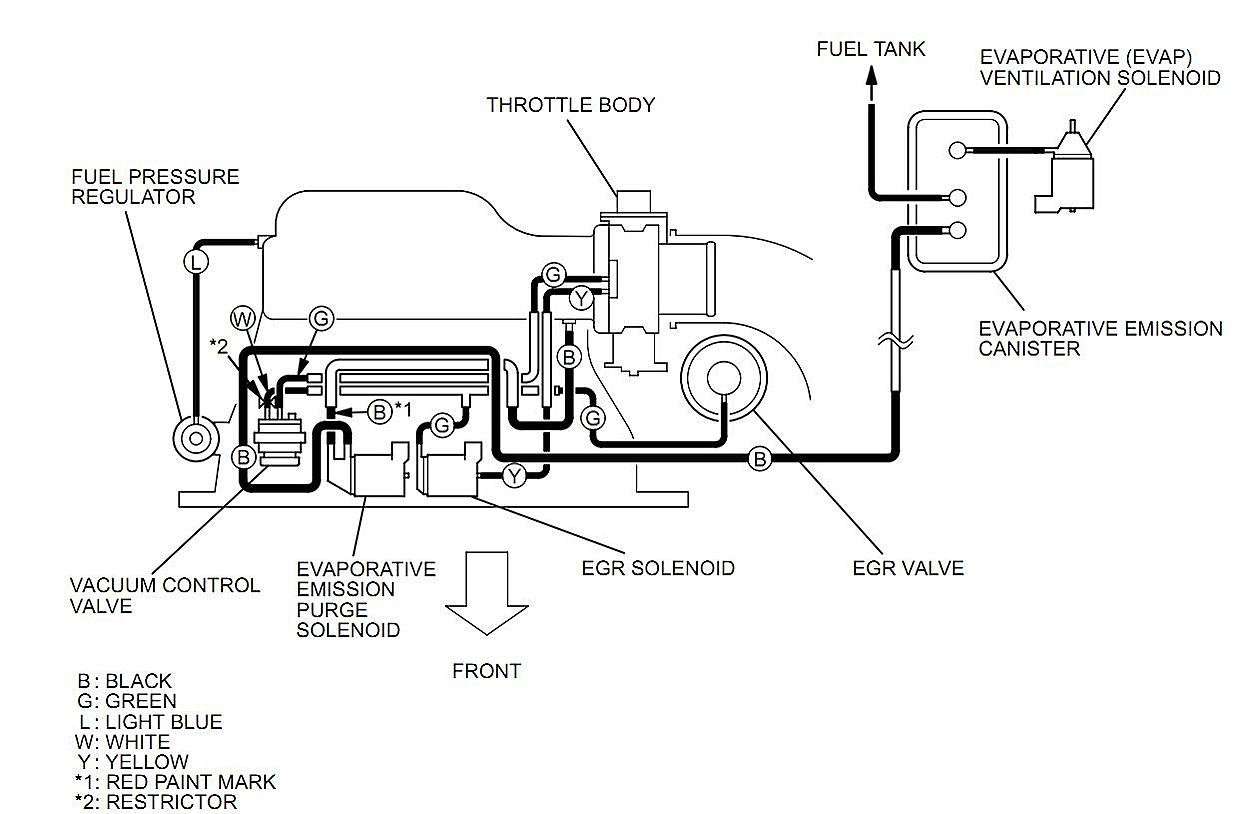

Well here is what I did today;
Traced the hoses to make sure all were secure. During this process I noticed that the entire hose system connects to two location at the Throttle Body. This is where some of the intake comes in. The end of the system is the EGR Valve where the emissions exits the system and returns to the Intake Manifold. If you take off the hoses to the Throttle Body one has a large opening while the other has a tiny (smaller than a staple) hole. I decided to remove the Throttle Body from the Intake Manifold and clean it.
While I was cleaning I noticed that the tiny hold that leads to the top was completely clogged and I couldn't even blow into it. I first blew it out with an air compressor and then shot some carb cleaner through it. Then I cleaned their entire inside of the Throttle Body. It looks like it's leaving the factory brand new.
Put it all back together according to the diagram attached.
Everything runs great. I cleared the error in the system and now I just have to drive it around for a week or two to see if it comes back (it took 8 days last time I made a change). I'll keep everyone informed.
If it comes back, fingers crossed that it won't, I will be taking the entire weekend and performing every pressure, voltage, and omh test recommended in the FSM.
