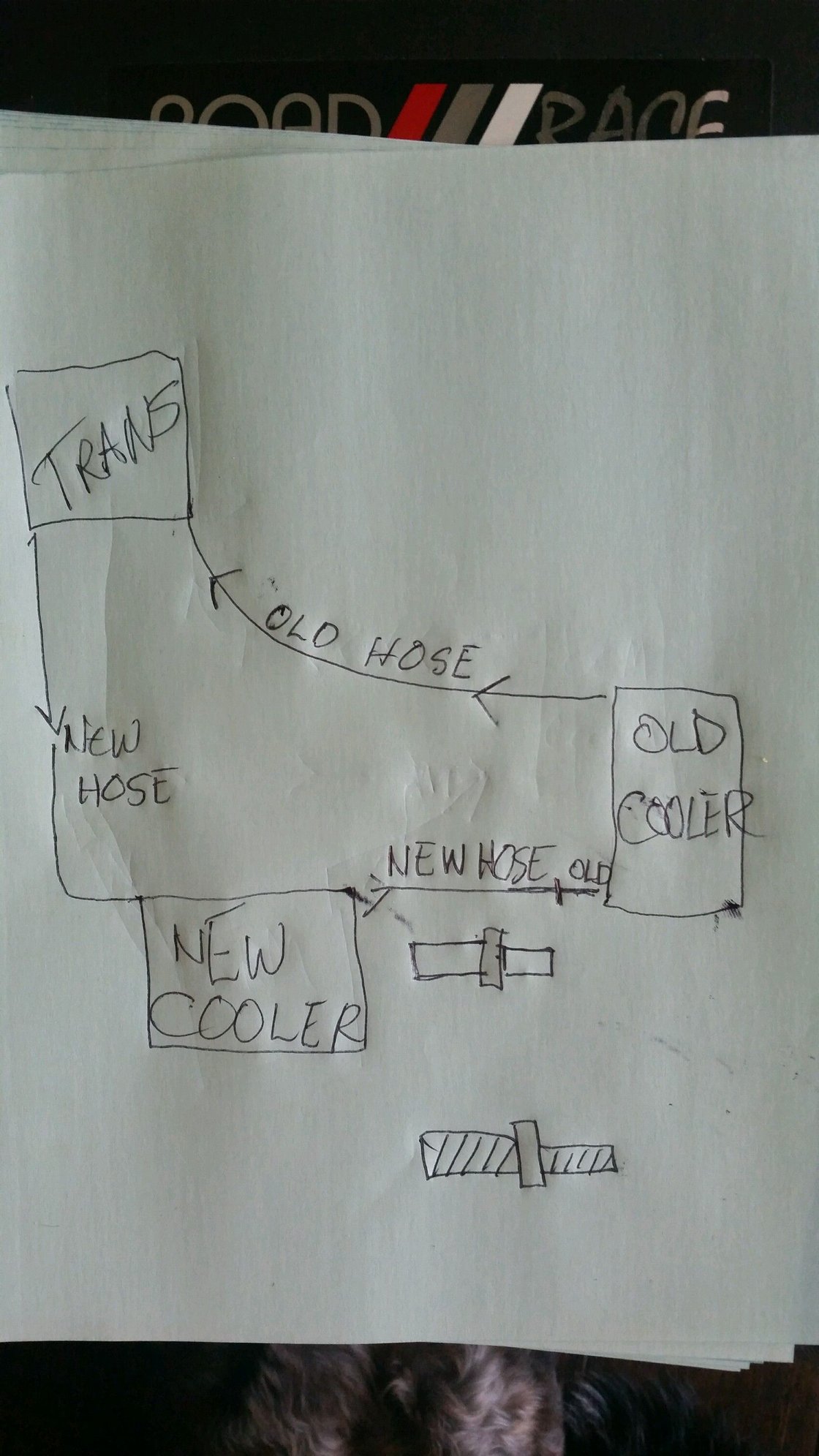

The front bumper has to be removed. I utilized a step by stepwalkthrough found on this forum in order to accomplish this. We moved forwardwith an in-line installation plan therefore the transmission fluid willcontinue to run to the OEM cooler then into the oversized cooler; finally goingback into the transmission.

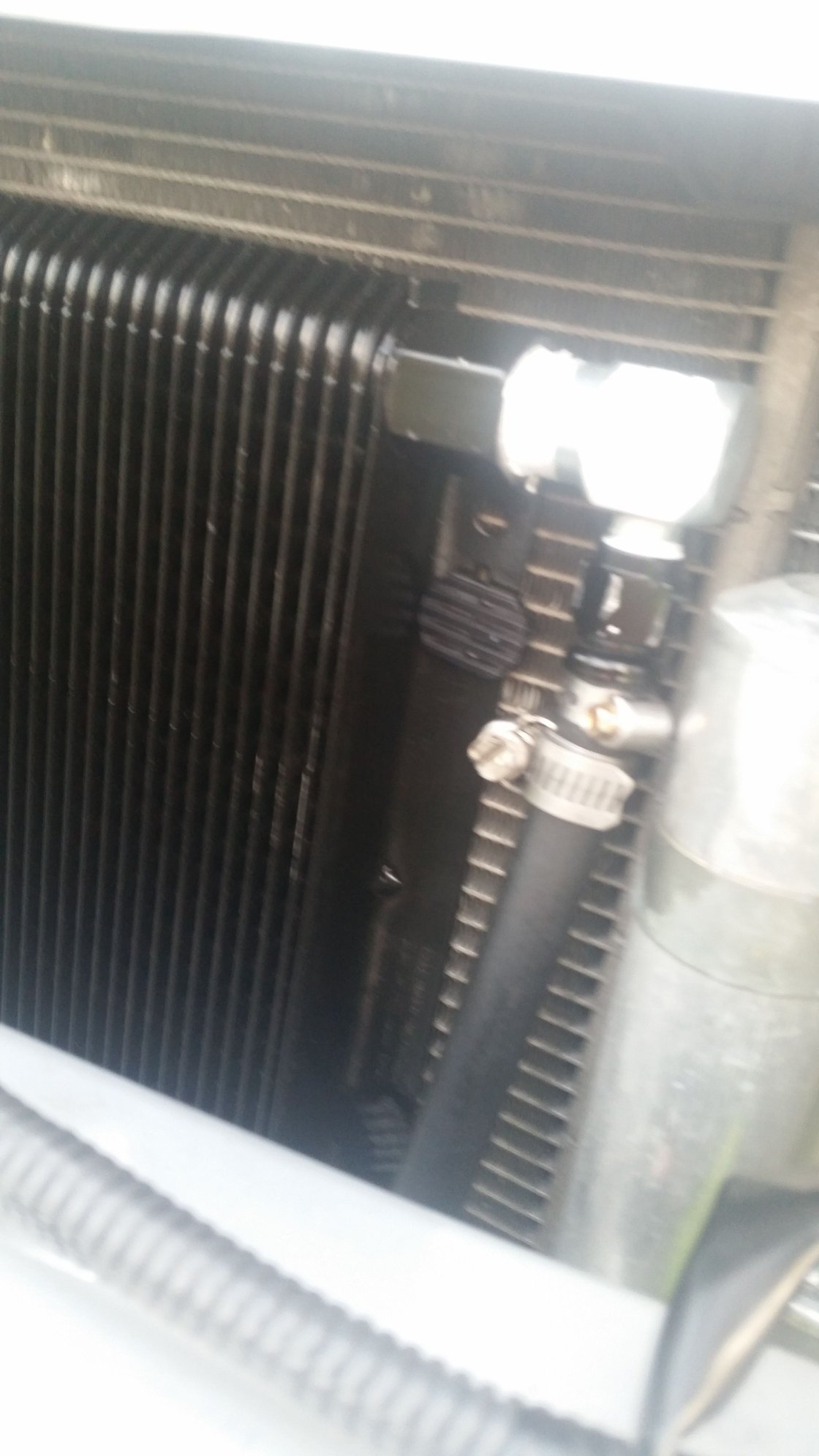

Image #3: The Oversized Transmission Cooler will mount in front of the air conditioner radiator. The mounting hardware will go through both the air conditioner radiator and engine coolant radiator. I have a Mishimoto Aluminum Radiator and there were no issues at all.

Image #5: Top view of the new cooler completely installed and secure.
Image #6: Bottom view of the new cooler completely installed and secure.
Image #7: In line Installation Layout Plan.

Image #9: Road Race Motorsports Oversized Transmission Cooler installation complete. Test drive completed as well and no issues what so ever to report. The transmission is being kept cooler and she is shifting much crisper.

Thanks for sharing. I always wondered how this kit was installed. My concern with this kit after seeing it installed, is that it seems like you need to have the OE cooler to tap into.
I know my 09 lancer didn't have an OE cvt cooler and the lines just went from the tranny mounted cooler/warmer back to the cvt. So it looks like guys that lack a cvt cooler to begin with will need to buy and install the fixture that can accommodate the OE cooler first and then get the add on. Or do that and just install a larger than OE aftermarket cooler and call it a day.
Pic attached is what you need to have to run an external cooler. Lancers that don't have the OE cooler are missing the 2 skinnier lines that act as the send and return lines to the cooler.
