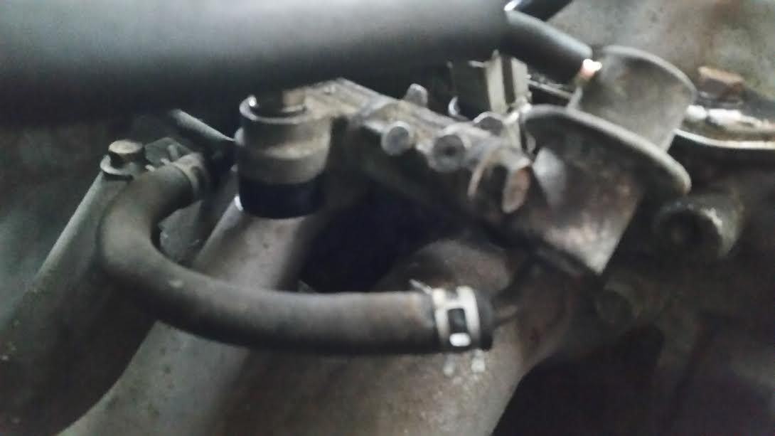

The return line should hook up to the bottom of the fuel pressure regulator that is on the end of the rail. Also they didnt put plastic valve covers on until 04-05. So ide say someone swapped that engine before you got it.
The bottom one with the hose clamp is the return line<br/>
another view of the return line<br/>

Thank you very much sir!!! I really appreciated it. and yep, this is definitely a newer engine...
Ah well it works fine and runs great, I will probably just plug the return line to tank and let it be.
Thanks again man!

yeah ide just put some rtv on a appropriate size bolt and run it into the return line, should work just fine!
