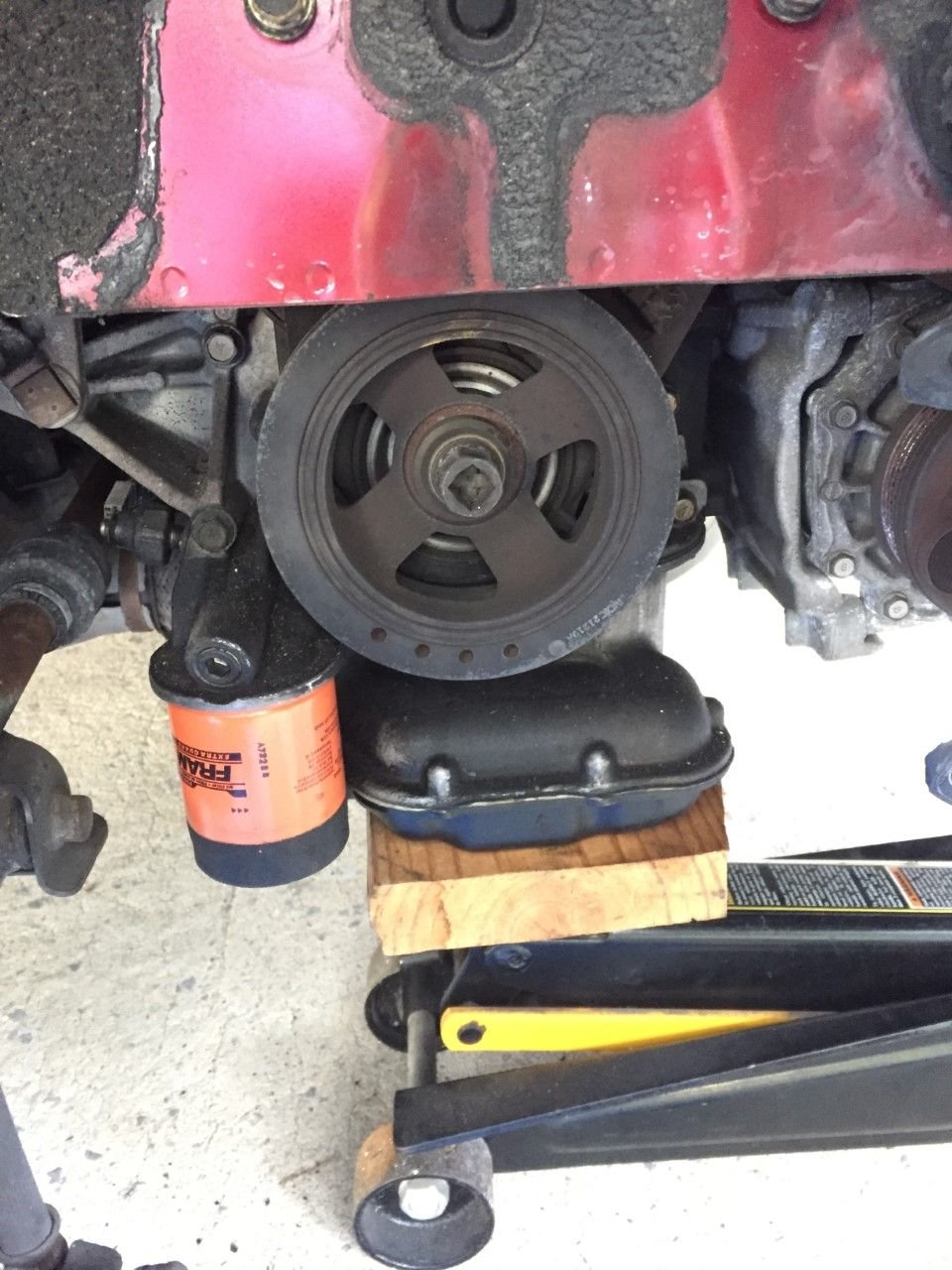

My belt stripped while driving and, at the time, I didn't realize what was going on so I kept trying to start it. I got the car towed home and eventually found that the timing belt had stripped teeth. Bought the timing belt kit and got up to the point of needing to take the crankshaft pulley off. I noticed while I was trying to loosen the bolt using a wrench that the pulley spun with very little effort. Is that a bad sign something is wrong or is that ok for it to spin like that? It's not free spinning or anything like that but, there's little resistance and no noises either. I assumed it would be harder to spin than that, so I figured I'd ask before going any further.

Did you ever find out why the crank pulley was spinning? Was it spinning on the crank? Was the crank itself spinning?

The crank with the pulley were spinning together when I spun it. I thought there would be more resistance to it when I spun it without the belt in place, but from what I understand, that's normal.

There should be resistance from the valve springs, even more if the plugs were still in.

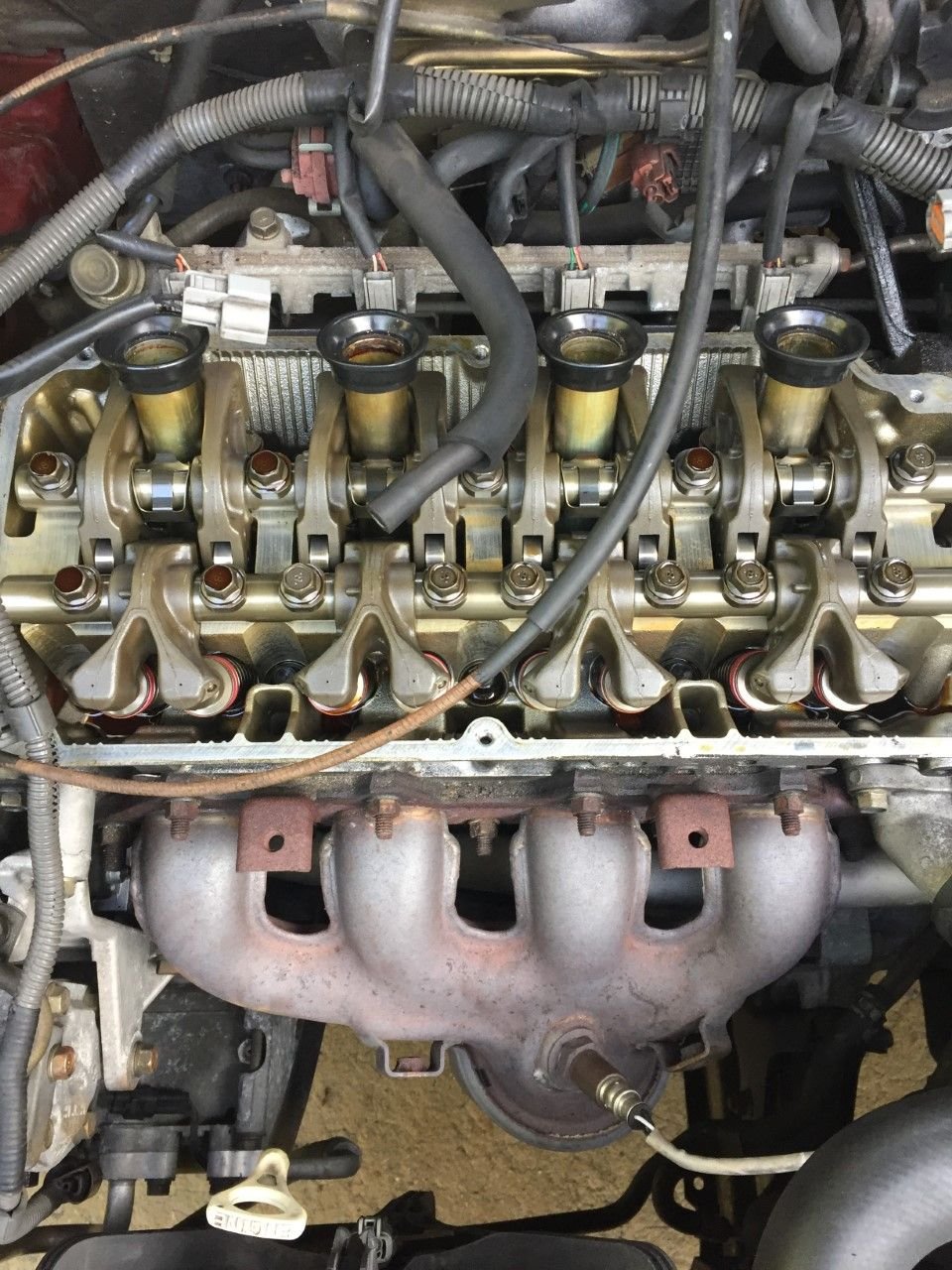

Looking at the engine from the front, which one is cylinder #1? Far right or far left? Also, is there a way to tell whether the valves are bad by checking anything under the cover? I don't have the tools for a compression test. I can move the rocker arms (?) up and down on the intake side when the springs aren't compressed, but on the exhaust side, I can barely move them.
