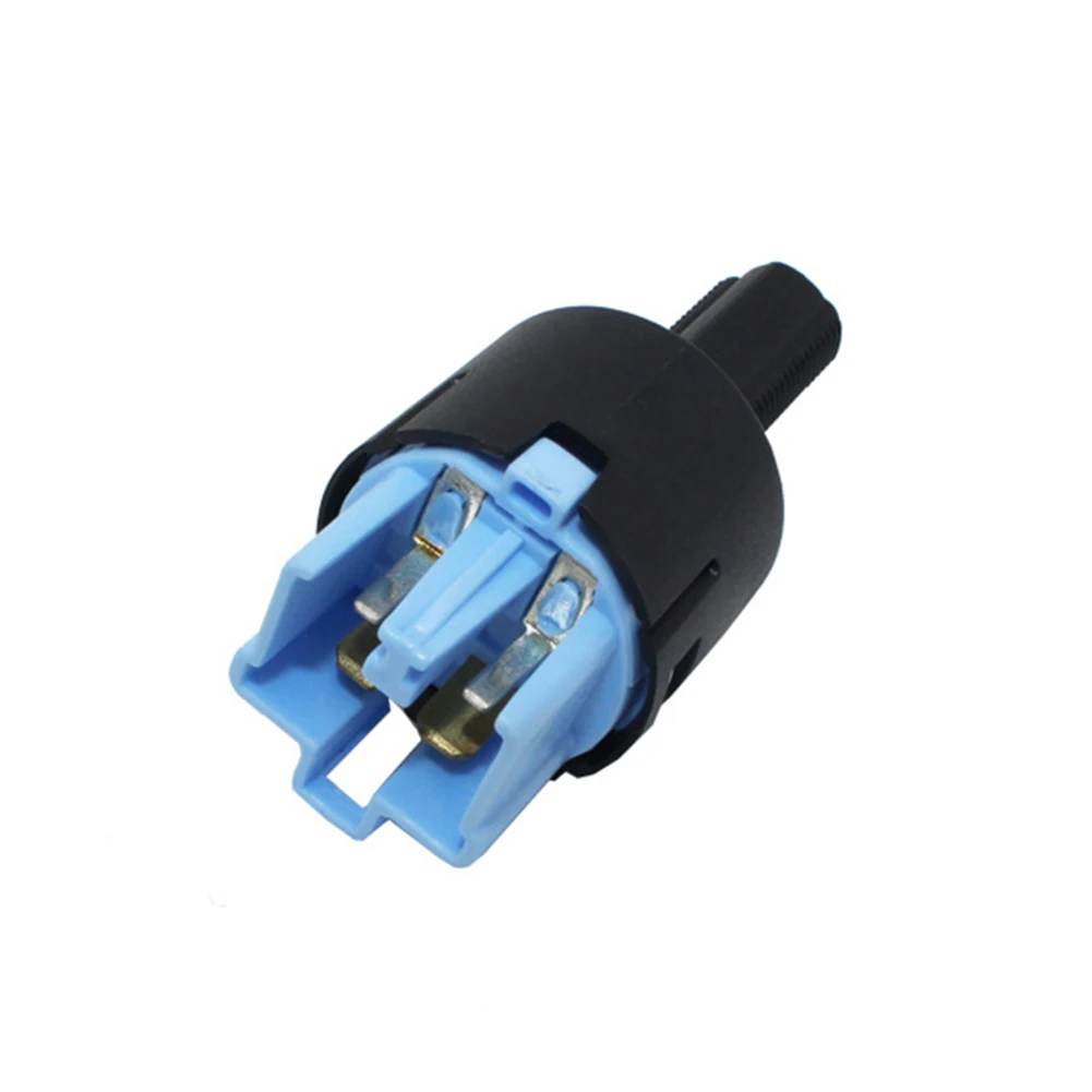

If your gear shifter has stuck in the park mode, please don’t panic. As I said before, you can use the manual button that you can press to shift from the parking mode. I have called the Mitsubishi dealer to find out if one called them with this problem. They offered me to bring in the car but I rejected. The technician on the phone said to buy a new “brake switch” and the problem should go abroad, so I did. First, you can look at your fuses before buying the brake switch . Sometimes the dilemma can be with the brake lights, but in my case it wasn’t, and the fuses were all excellent. When I replaced my brake, switch, the problem didn’t go away, and I had to take it apart to get to the
<-- check this link to see a video on how to get there.
When I took everything apart, the lock system worked correctly which surprised me, so I set all back. After driving it for one day the issue came back, so I had to get it apart again!!! Don’t MAKE MY MISTAKE DON’T PUT SCREWS and plastic BACK TILL YOU KNOW YOU GOT IT FIXED. I had a feeling that the problem might be with the wires or solenoid. I couldn’t find the OEM solenoid, but oftenest of the time that would be the cause of the issue. In my case, the solenoid worked perfectly every time I took it a part. Playing with wires (green/ white) I realized that when I pull the solenoid doesn’t work, but when I push them forward it does. I was able to take the plastic piece off that locates slightly above the solenoid. Taking it off and I saw the “electrical switch” ( Part # AV634564) that was attached to green/ white wire. By ordering a new switch for $15 I was able to fix the problem. The cause of the problem was with the electrical switch. Hope this helps.
