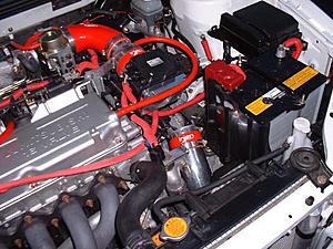

this is just a fore-warning of what i had happen this weekend, for those that have the injen CAI, check the welds on the lower elbow where it mounts on top of the thermostat.....and the MAS adapter here are the pics of what happened, and it is not cause by tourqe.....this was i believe a faulty piece because of how clean the break was check these out

MAS adapter ....NOTE: the piece that is show is saposta be welded to the whole MAS adapter housing

i was lucky to get the replacement b4 HIN in 3 days.....and it was a warrenty replacement

this is the last pic, this is the piece that mounts on top of the thermostat, as u can see it was a clean, faulty, break

Yours broke differently than mine. Run a search and you'll see the other (bigger) thread on probems with Injen CAI's.

I think it was just lack of foresite and endurance testing. The metal probably fatigues under extreme and rapid temp changes with lots of vibration. **** happens. So long as they do something to fix it I don't mind. I still haven't even contacted them.

I think Phattroc just got a bad intake to tell you the truth, but obviously I can't say for sure. A company with a good rep like Injen wouldn't just mass produce poorly welded and flimsy intakes if the planned on keeping their products out there. I still think vibration is the major issue coupled with the added stress of extreme temp changes.

All you do is praise RRM anyway. They're a great company and I'm sure everyone appreciates what they've done for us, but they're not the end all. Granted the Injen has issues, but depending upon how Injen handles these problems it may be a non-issue. Who knows, there could be a change of materials or redesign in Injen's future. For the time being (again) I'd just put a bushing under the mount to ease the effects of vibration on both the forked mount, the weld, and the piping by extension. I think Injen has a good enough rep overall to make this right.
