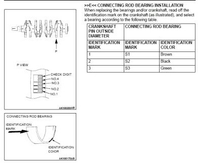

Allegedly the engine is balanced from the factory and there are a few different types of weights for the rod bearings. I did not see this in my motor. I had the same 8 rod bearings with zero difference between any of them. The only place I know to find stock parts is probably not going to be very affordable though.
http://www.mitsubishiparts.com
BTW, some guy on E-bay was selling a spare block recently which may or may not include rods and bearings (I'm not certain). May wanna check there too. Good luck.
Mechanical parts >> Engine >> Pistons, rings and bearings >> and the three types are listed. Brown, black and green. All of mine were black.
$15.00 ea. cylinder it seems. From the description it seems they're listed in pairs.

ya unfortunally because the engine is balanced each part has different measuements
ive been told there are 4 different colors for the bearings themselves.
i figured i would just buy all four colors. and fit to match

each bearing has a different thickness. so ive been told anyways.

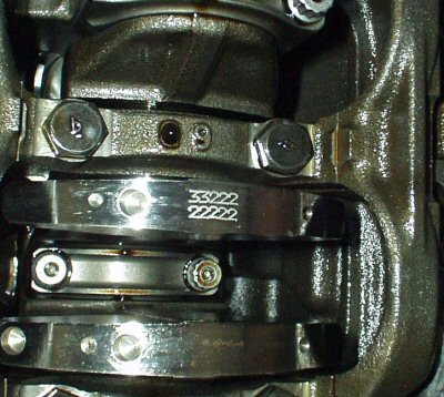

ok i got a pic of the crank
any a pic of the pdf i have.
what do you people think?
