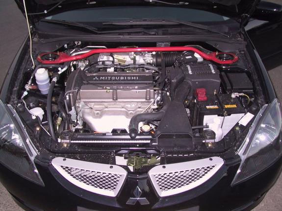

^that looks like a compressed 4g63??? im really confused about this engine... i think i remember the intake manifole folding back further to accomodate the large fuel rail..

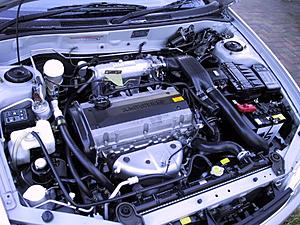

With that pic, I'm leaning towards the rare 4g93E (DOHC) . . . whether it's the true 4g93T, I can't verify seeing any turbo stuff. One clue: look at the skinny intake mani (log style) . . . the 4g63's IM goes along the length of the block while the 4g93 cuts short and is bigger in size.
I have loaded a pic from YogiB's (from NZ) ex-mirage/lancer (CE chassis) VRX. This is a true 4g93T. Yes, Yogi is on this board. You can PM him to verify the pic of his ex-car. Many kudos for him sharing the pic w/ me.
BTW: The only 4g94 DOHC was the GDI version if I'm correct.
BTW 2: I have added the other pic. Look at the exh mani . . . a true 4g93T would have the same design/style, turbo mani like DSM and Evos. Was the pic on the black lancer taken by first hand experience or copied off the net? If it's the latter, I'm thinking it's a Taiwanese Virage.

Attached Thumbnails 2004 lancer es engine swap-img_887.jpg   2004 lancer es engine swap-raevo-copy.jpg
