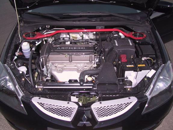

Here..

^ is this supposed to be a pic of the swap?

which swap?

the one that this topic was started for^ that does look like a 4g94 in there

I really doubt that's a pic of the swap that we're all here to hear about. Remember illuminati was saying the shop was ahving some problems and wanted him to come in? I don't think they resolved everything in 36hours and have the car totally back together.
