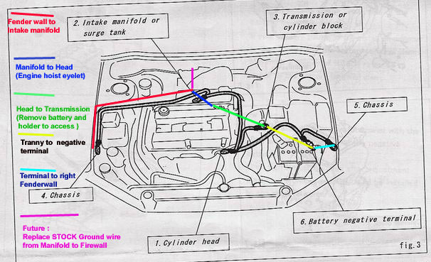

can someone post an installation instruction with pictures of all the mounting points. I would love to know where all the ground points are so i could do it myself.

The above pic doesn't really help much. A 4G94 specific diagram would be more usefull. I just used all the regular grounding points. However there's one, down by the transmission that has a huge cable that was too big for my kit.

if you read on the side of that diagram it says exactly where they should be mounted, and if you look many of those points already have grounds on them, you're just beefing it up

That pic look very specific, what do you mean by "regular mounting points" (LancerMMC). I dont know what they are...

ok, i just installed my ground kit based on the diagram shown above. I connected the neg on the battery and daisy-chained it to the right side chassis, to the other engine hoist bolt on the head (the one without the lift eyelet), to the transmission bell housing, to the intake manifold, then to the left side chassis. Did i miss any spots?
