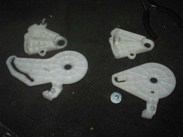

Here are some pics of the lever assemblies. There is definitely a difference between the two. The one on the left is the assembly that came in my car. I was not able to turn the temperature dial at all with those in. I pulled the parts on the left from a friends car that was the same year as mine, 2003. It has fixed the temperature dial problem. I can actually turn it. It's still a little tough, but it's not to bad.
