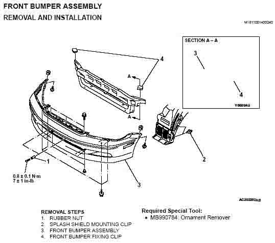

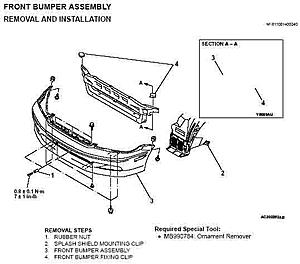

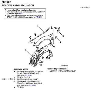

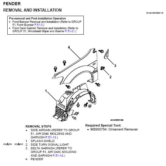

well since i feel bad for going off topic(not particularly something i do), here's some pictures to play with. looks as though the evo has more bolts to put on. if my roommate didn't crash his evo, i'd have a better answer. guess imma have to wait til Q4 when he gets the 9(bastard).
a possible problem for the evo headlights is that the lancer has a plate welded on for the battery support where the evo mounts it's battery further back in the engine bay. you might have to put the battery elsewhere as well.
there have been 2 members(i think) that have done the front end conversion using evo 7 parts. both have left the boards since then. i think one was calvinwich, and the other was from texas or somethin.

i always thought that 04 front lip is taped on..... there seems to be 1 bolt according to the pic
Old Jun 9, 2005 | 12:00 PM
Gunshin's Avatar
Joined: May 2005
Posts: 85
From: Phoenix, AZ
There's actually 4 bolts if you follow the lines, 2 in the middle, and 1 on each side, plus 14-18 of those nut looking things, presumably pop-rivots.
